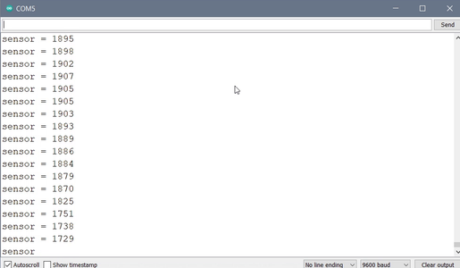

To make this magnet useful I have to convert the magnetic field into an electrical signal, for that we need to use a hall effect sensor. To be exact I will be using a 49E linear hall effect sensor.
This sensor will convert the strength of the magnetic field to an analog voltage which later we can read using a microcontroller.
After few experiments and playing with magnets and hall effect sensors, I found an appropriate distance between 2 magnets where the hall effect sensor value varies continuously when I move across them. This was very important because without this change in value detecting the motion would be quite impossible.
In my case, the distance was 3mm, it might be different for you because the value of the hall-effect sensor is based on the diameter, thickness, and material of the magnets.

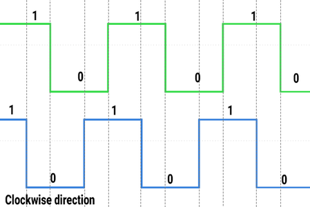

Step 7: Encoder Analogy

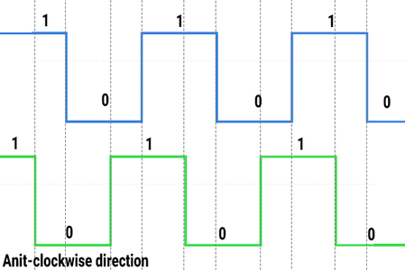

With this current setup, we can see the logic for navigating on the magnetic monopole surface
This idea was highly inspired by the rotatory encoder mechanism. If you have worked with the rotatory encoder mechanism before, you would already know that they work on the principle of phase difference. Where either one of the signals from the encoder will be lagging or leading and by using this phase difference we can determine whether we are turning the encoder in a clockwise or anticlockwise direction. I put a link in the description where you can learn more about the rotatory encoder.
Now, similarly, we are going to use 4 single with different phases where two are used to detect left, right and the other two are used to detect up, and down.
Note : how does an encoder work
Step 8: Find the Motion and Direction of the Hall Effect Sensor
At first, it’s hard to notice or a little bit hard to imagine how we can implement the encoder analogy using the magnets. But it was quite interesting to see how they work.

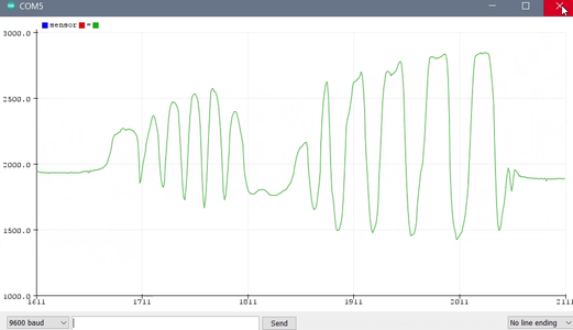

First, map out the magnetic field of all the magnets from the pad. This should give us this approximately a sine wave as we sweep the sensor across the grid, where the top peak of the sine wave is the maximum magnetic field read by the hall effect sensor and the bottom trough is a minimum magnetic field read by the hall effect sensor.
Now with this hall effect sensor value, we can find the motion and direction of the Hall effect sensor by comparing the past and the present reading.

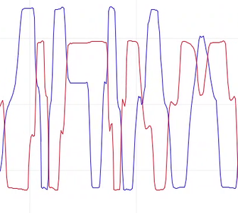

If I fix both sensors in the same plane and start to move the plane you can see both the hall effect sensor value changes, either if you go left to right or up to down. This makes it very complicated to determine, what direction exactly the mouse is moving.
To fix this I will add another set of Hall effect sensors. Where we’ll use two of them to detect left, right motion and the rest two for up, down motion.
Step 10: Adding More Pairs of Hall Effect Sensor

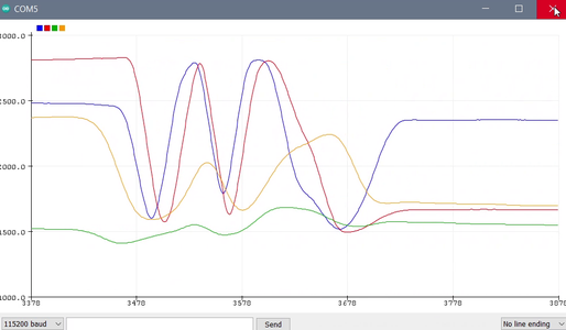

This extra set of sensors will create an offset in the reading, if you see the left, right sensor reading together, either one of them will lead or lag as I move my mouse left and right. Exactly this is applicable for up and down as well. Which we could do with a single sensor as well.
The interesting part about this is, the phase shift occurs only on one set of sensors reading have the phase shift when the plane is moved in a single direction (either up/down or left/right), and for the remaining set of sensors, no phase shift occurs [ideally].
So, by arranging the sensor in this we way, we can detect all 4 direction which we use to move the mouse on the screen in all direction.

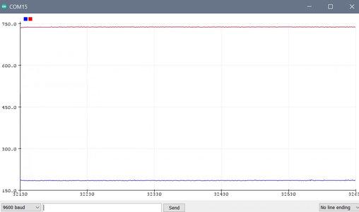

For the code, The first step was to clean up the signal.
Here you can use different types of filters and digital signal processing methods to clean up the noise. But to keep it simple and fast, I'm going to just smooth out the signal by averaging it. Then I took the rotary encoder example code and modified it a bit to detect the motion by using all four sensors. To be honest this is one of the worst codes I have written in a while because I lost my patient after dragging this project for way too long.
