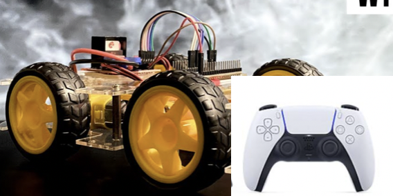

Introduction: ESP 32 WITH PS5 CONTROLLER CAR
The ESP32 car is a small robotic vehicle powered by the ESP32 microcontroller. It is designed to be controlled remotely using a PS5 controller, providing a seamless and intuitive interface for driving the car.
The ESP32 microcontroller is a versatile and powerful device known for its built-in Wi-Fi and Bluetooth capabilities. It allows the car to establish a wireless connection with the PS5 controller, enabling real-time control and responsiveness.
To set up the system, the ESP32 car needs to be equipped with a motor driver module that can control the movement of the car's motors, such as DC motors or servo motors. The ESP32 communicates with the motor driver, translating the commands received from the PS5 controller into appropriate signals for controlling the motors' speed and direction.
The PS5 controller is a popular and ergonomic gamepad designed for the PlayStation 5 gaming console. It offers various buttons, triggers, and joysticks, allowing for precise control inputs. By connecting the PS5 controller to the ESP32 car via Bluetooth, the user can wirelessly steer the car, accelerate or decelerate, and even perform other functions depending on the available controller features.
The ESP32 car's software is responsible for receiving input from the PS5 controller, interpreting the signals, and converting them into motor commands. It may include a mapping system that assigns specific controller inputs to corresponding car movements, such as forward, backward, left, and right.
Overall, the ESP32 car controlled by a PS5 controller offers an engaging and interactive experience. It combines the power of the ESP32 microcontroller, the versatility of the PS5 controller, and the convenience of wireless communication to create a fun and user-friendly remote-controlled car.

Step 1: Assembling the Chassis
assembly of chassis video
https://www.youtube.com/watch?v=dJszq4B5T5M
Step 1: Prepare the Chassis
  1. Lay the chassis on a flat surface with the top side facing up.
  2. Locate the four mounting holes on the chassis. These will be used to attach the motors later.
Step 2: Attach the Motors
  1. Take one motor and align its mounting holes with the corresponding holes on the chassis.
  2. Insert screws through the mounting holes of the motor and tighten them securely using a screwdriver.
  3. Repeat this process for the remaining three motors, ensuring that they are evenly spaced on the chassis.
Step 3: Mount the Wheels
  1. Take one wheel and slide it onto the shaft of a motor.
  2. Use a clamp to secure the wheel onto the motor shaft by tightening the screw on the clamp.
  3. Repeat this process for the remaining three wheels and motors.
Step 4: Connect the Motor Driver
  1. Identify the L293D motor driver board. It will have multiple pins and screw terminals.
  2. Connect the four motors to the motor driver board using jumper wires. Ensure that each motor is connected to the correct terminal, usually labeled "Motor 1," "Motor 2," "Motor 3," and "Motor 4."
  3. Connect the motor driver board to your microcontroller or Arduino board according to the manufacturer's instructions.
Step 5: Install the Battery Box and Switch
  1. Locate the battery box and switch.
  2. Attach the battery box to the chassis using screws or adhesive tape, ensuring that it is securely mounted.
  3. Connect the positive and negative terminals of the battery box to the corresponding terminals on the motor driver board.
  4. Mount the switch on the chassis using screws or adhesive tape.
  5. Connect the wires from the switch to the power input of the motor driver board, ensuring the correct polarity.
Step 6: Optional - Install a Speed Controller
  1. If you have a speed controller, connect it to the motor driver board according to the manufacturer's instructions.
  2. The speed controller will typically have inputs for controlling the speed of each motor. Connect the appropriate wires to the motor driver board.
Step 7: Final Checks
  1. Ensure that all connections are secure and free from any loose wires or components.
  2. Double-check that the motor wiring is correct and matches the motor driver board connections.
  3. Confirm that the wheels are properly mounted and can rotate freely.
Congratulations! You have successfully assembled the 4-Wheel Drive Smart Robot Bot. Now you can power it on and program it to perform various tasks or movements using your esp 32.
