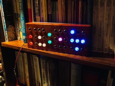

It´s been a long time since the hype for the tix clocks has faded. I started building it at the beginning of 2014! but, 2 kids and moving abroad made this project to fall in the list of priorities.
The idea of a tix clock is to count the dots that are illuminated. Each group illuminates the amount of LEDs corresponding to its digit of the time read in the HH:MM format. I know, life is hard enough to complicate reading the time, but it has color lights!
For this clock I used mostly scraps I had laying around. My wife had some unused lab tubes from some old experiment. She had like, hundreds of them, and I was wondering what could I do before discarding them.

Step 1: Preparing the Wood
The first thing is to prepare the wood, with my materials I draw in CAD the layout for the holes to be drilled. Attached is the version I used. I added a line that measure 1". If you use this, print and check the scale until that line measures exactly 1".
If you are making one from scratch, I recommend to draw the crossing lines, so when you drill the holes is easier to pinpoint the center.
After I printed the model, I checked the alignment and then I glued with school glue, like Elmer's glue, to my piece of wood. Let it set for a while, because if you start drilling with the glue still wet, you´ll end with a torn and misaligned guide.
Once the glue is set, proceed to drill the holes. Since my tubes where a little less than 1/2", I used a 1/2" drill bit. If you have a different diameter of tube, I would use a 1/16th" bigger drill, or maybe 1/8th". It´s important to mention that probably the diameter will shrink a little when applying the finish, and since we´re working with glass tubes, a smaller diameter will probably end in a broken tube.
Once you are done drilling the holes, you can dampen the paper guide and remove it. Check if the tubes can go through, and start sanding. In my case I started with 150grit then moved to 220grit and went up to 400grit. In my opinion, 220 grit was good enough.
I applied the finish with a rag, let it dry and sand with the 400 grit to remove those little hairs that rise in the wood. after that, cleaned it up and applied a second, third and fourth hand. Follow the recommendations from the manufacturer for curing time, but every layer you add, give it a little more time to cure.
Regarding the sanding, you probably won´t need to sand each layer, just check if you need to get rid of some imperfection, if not, apply the next coat.

Step 3: Electronics - Wiring the LEDs
The wiring is very simple, just solder the 3 cables (VCC - GND and Data Line) joining every WS2812b. I Used solid coper wire to make it easier the soldering and fixing to the wood.
Since the separation is always the same, you can precut the wires and solder to the LEDs. Just respect the direction of the data line. I used red for VCC, black for ground and green for Data Line.
in one of the ends, I soldered a small PCB with 3 pins just to avoid the wiggling in the last LED, and to make easier to attach a back for the clock.
In order to fix the LEDs to the wood I used pieces of aluminum with some small screws.
Step 4: Wiring the Micro Controller
This is very simple, the connections to the Wemos are as following:
5V ---> Power source +5V
GND ---> Power Source and the black wire from the "LED Snake"
D5 ---> Level Shifter--> Data Line of LED (check the direction of the arrow in your LEDs, you have to connect it to the first one.
That´s all. But there is one thing, the WS2512b are 5V and the WeMos´ data pins are 3.3volts, and as far as I know, they are not 5v tolerant.
Since the WS2812b acts weird when you attach to a 3.3v data line, I used a Level shifter, the only thing you have to do is provide 5v in th "High" Side, 3.3v in the "Low" side and a ground. You can use the Wemos 3.3v pint to provide the lower voltage.
Then you can connect the D5 Pin from the Wemos at one of the pins in the "lower" side, and the data pin from the LED strip to its correspondent pin in the Higher side.
At this point, you can burn the fastled Examples just to show off the colors and check if everything is ok.
The only parameters you need to replace are the data pin (since it´s a wemos you have to write D5) and the number of LEDs (32 in this case) hit upload and it should start displaying colors.

    ArrayShaker(H, 1);
    ArrayShaker(h, 2);
    ArrayShaker(M, 3);
    ArrayShaker(m, 4);
void ReadTime() {
  timeClient.update();
  //Get the values of each digit Hh:Mm
  hora = timeClient.getHours();
  H = hora / 10;
  h = hora - (H * 10);
  minutos = timeClient.getMinutes();
  M = minutos / 10;
  m = minutos - (M * 10);
void colorSelect() {
  colorH = 0xFF0000;
  colorh = 0xFFFF00;
  color2puntos = 0x00FF00;
  colorM = 0xFF007F;
  colorm = 0x20B2AA;
void setup() {
  Serial.begin(115200);
  //randomSeed(analogRead(0));
  //set led pin as output
  pinMode(BUILTIN_LED, OUTPUT);
  ticker.attach(0.6, tick);
  FastLED.addLeds<CHIPSET, LED_PIN, COLOR_ORDER>(leds, NUM_LEDS).setCorrection( TypicalLEDStrip );
  FastLED.setBrightness( BRIGHTNESS );
  timeClient.begin();
  FastLED.clear();
  WiFiManager wifiManager; //  wifiManager.resetSettings();
  wifiManager.setAPCallback(configModeCallback);
  if (!wifiManager.autoConnect("Mega-Reloj")) {
    Serial.println("failed to connect and hit timeout");
    //reset and try again, or maybe put it to deep sleep
    ESP.reset(
    delay(1000);
  //if you get here you have connected to the WiFi
  Serial.println("connected...yeey :)");
  ticker.detach();
  //keep LED on
  digitalWrite(BUILTIN_LED, LOW);
/*Wiring/location of numbers:
  H from LED 0 to 2
  h from LED 3 to 11 (ubi 2)
  : LEDS 12 and 13
  M from LED 14 to 22 (ubi 3)
  m from LED 23 to 31 (ubi 4)
void loop() {
  ReadTime();
  //Select color.
  colorSelect();
  //Assign and Randomize the position vector corresponding to each digit (ArrayShaker)
  updatenumbers();
  blinkingcolon();
  Serial.print(", ");
  Serial.print(timeClient.getHours());
  Serial.print(":");
  Serial.print(timeClient.getMinutes());
  Serial.print(":");
  Serial.println(timeClient.getSeconds());
  delay(1000);
  FastLED.show()<br>
