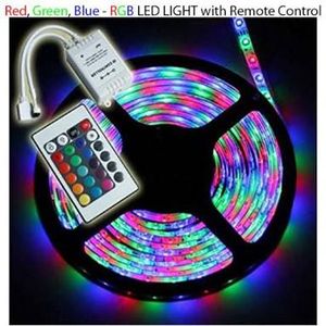

RGB LED Strip (with controller & remote):-
https://www.banggood.com/DC12V-24W-2A-5M-Waterproo...
https://www.banggood.com/DC12V-5M-Non-waterproof-3...
https://www.banggood.com/DC5V-1M2M3M4M5M-USB-IP67-...

Step 4: RGB LED Control
so connect your mobile or your pc to the same network of which ssid & password you entered in the code then open the browser & type ip "192.168.43.72" and open this page & the remote as shown in image will appear then place the receiver of controller of RGB LED Strip near the IR LED connected to the nodemcu so that IR receiver of LED strip will receive data properly & when you press any key the browser the LED strip will behave according to the key pressed in the browser.
