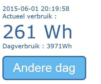

To do so you use a little app in a web brower (see image). The app displays the preset possibilities in a button. In this case :
  • now (NU)
  • between now and 17h today (VANDAAG) (not displayed in image)
  • between 22h today and 6h tomorrow (NACHT)
  • between 22h today and 17h tomorrow (MORGEN)
you can change these settings in the database.
The button shows how much power is available in the 2 hour cycle (set in de DEVICE table) from the forcasted wind power production. If there is enough power, the button is green, if not enough it is red (also set in the DEVICE table). The button also showes the switching time.
All you have to do is go to the website (192.168.0.156/Vaatwasser.php) and choose the moment you want. the dishes to be done. Once you have done so, a green bar will apear with the switching time.
