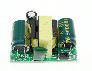

  1. 220V to 5vdc transformer

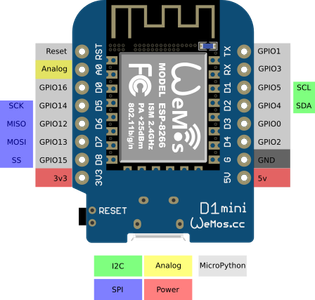

  2. Wemos D1 mini ( / pro for better wireless range)

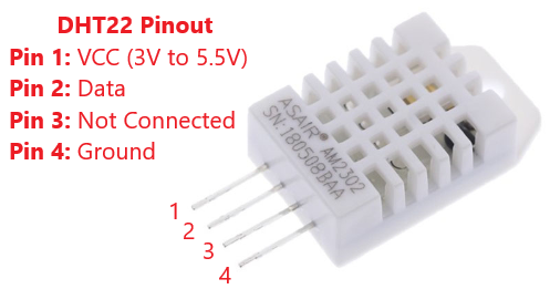

  3. DHT22

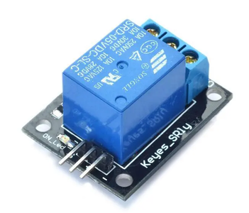

  4. 1 Channel relay

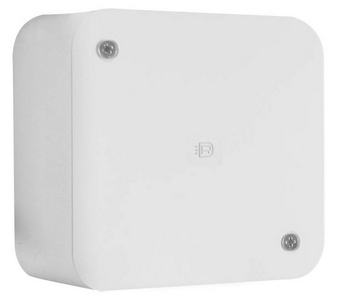

  5. Relay box

From the power source 5v output 3 wires will go to:
  • wemos d1 mini (5v and ground)
  • the relay (5v and ground)
  • dht22 (5v to pin1, gnd to pin 4)
Data pins
  1. relay (d1 mini pin D1 to the IN pin)
  2. dht22 (d1 mini pin D2 to pin 2)
