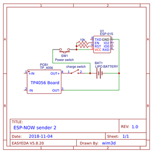

I made two different remotes/senders:
Sender 1: The esp8266 is in deep sleep and is activated by a reset.
The led in the button lights up and dims when the module is done. If the voltage of the battery is to low, the led blinks. If the ESP-NOW failed, the led blinks before changing to WiFi/MQTT connections. The esp8266 is powered from a LiPo battery with a HT7333 voltage regulator to 3.3V
Sender 2: The esp8266 is powered off and is powered by pressing the button.
Normally the ESP-NOW connection is done after the button 'clicks'. The esp8266 is powered directly from a LiPo battery. I do not know if the esp8266 gets damaged by the high voltage of a fully charged battery (up to 4.2 V) when it is powered on just a few 100 ms. It is higher then the specs (3.0 - 3.6V).
Note: if the battery power is low, the ESP-NOW fails.
