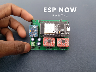

Hey guys, welcome back in my new Instructables. Few days ago I decided to make a self balancing robot. To make a self balancing robot we need to prepare software part & hardware part. So here I'm preparing Software part of my robot my robot. You can also call a brain of it. Because we will use this pcb to provide commands to our robot.

Start by finalizing my PCB design using mine preferred design software. Once satisfied, I saved design files in Gerber formats. For designing a PCB I recommend Kicad Because it's preferred for beginner.
I designed this PCB according to me needs;) it has some additional features like I can control two Nema17 stepper motor one Servo Motor and even a Buzzer & LEDs wirelessly, using my smartphone.

After Receiving PCB, Solder some remaining components like Header Pins, Buzzer, Capacitor & Screw Terminal. After the process of soldering use a IPA to clean the PCB and provide a professional look. For better soldering, I recommend to use Sequre SI012 Pro Soldering Iron, Because I love it have a lot of features and powerful Also.

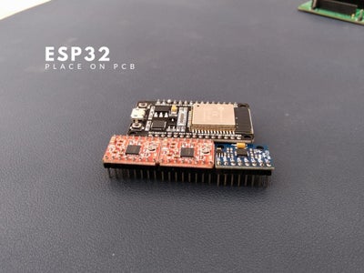

Step 4: Place the Components
After Soldering Process, place the necessary components like stepper motor driver, ESP32, MPU6050, etc.
