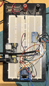

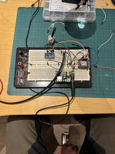

Step 3: Breadboard Setup
The first test setup was quickly put together. For the ADC, I connected the ADDR pin to GND to get a stable bus address of 0x48.
Connecting the pressure sensors was straightforward. 5V (red), GND (black) and the output (yellow) to the ADC. The program was extended to integrate the ADC and display the readings from the web interface.
i2c:
sda: GPIO04 # D2
scl: GPIO05 # D1
scan: true
ads1115:
- address: 0x48 # ADDR -> GND
sensor:
# Sensor channel 0
- platform: ads1115
multiplexer: 'A0_GND'
gain: 4.096
update_interval: 1s
unit_of_measurement: "V"
accuracy_decimals: 2
# Sensor channel 1
- platform: ads1115
multiplexer: 'A1_GND'
gain: 4.096
update_interval: 1s
For the first test, I output the measurement directly in volts. We’ll get to calibration and conversion to bar later. This time I was able to upload the new software directly via OTA.
The sensor readings are around 0.499V at rest, which corresponds to the ambient pressure of about 0.9 bar. I tried a function test by blowing into the sensors, but I couldn’t achieve more than a 0.05V :-)
Knowing the difference between the two sensors would also be handy. So I quickly extended the code:
sensor:
# calculate difference between channel 0 and channel 1
- platform: template
name: "Pressure Difference"
lambda: 'return id(ch1).state - id(ch0).state;'

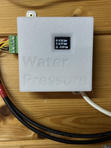

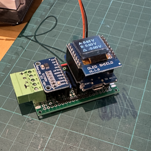

Step 4: OLED Display (Optional)
Now I could have moved on to developing the PCB, but there was still one problem. The D1 Mini already had pin headers soldered on top. Unfortunately, I didn’t have another D1 Mini without pre-soldered pin headers. I didn’t want to desolder them, and leaving them unused was absolutely out of the question!
So I rummaged around in my parts bin and what do you know: an OLED breakout board that fits perfectly on the D1 Mini.
The OLED display is also controlled via i2c. Luckily, I had used the same pins that the breakout board uses, so I just needed to plug it in! No additional wiring required!
Now just a quick software adjustment to bring the OLED display to life:
font:
- file: "gfonts://Roboto"
display:
- platform: ssd1306_i2c
model: "SSD1306 64X48"
address: 0x3C
lambda: |-
it.printf(2, 0, id(small), "0: %.2f V", id(ch0).state);
it.printf(2, 16 , id(small), "1: %.2f V", id(ch1).state);
it.triangle(2, 45, 7, 36, 12, 45);
it.printf(20, 33, id(small), "%.2f V", id(difference).state);

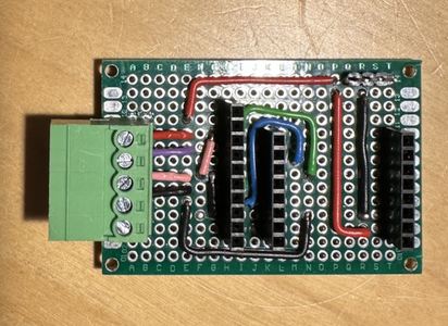

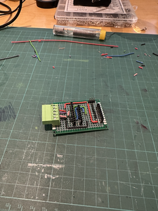

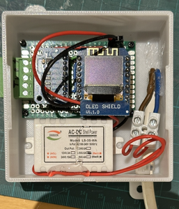

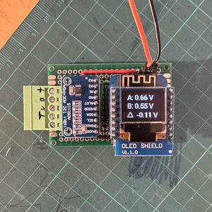

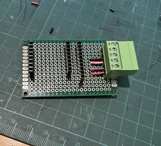

Step 5: Transfer to Perfboard

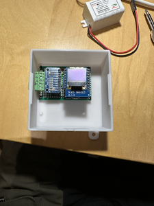

Alright, now the PCB needs to be created. Since I only need one unit, I skipped developing a proper PCB and just used a perfboard instead.

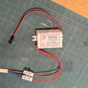

In order to be able to operate it directly from the power outlet, I also prepared the power supply unit.

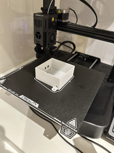

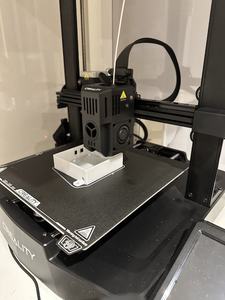

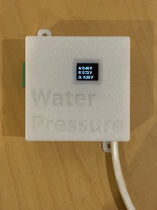

Step 6: Enclosure
Of course we still need a housing. So I created and printed a suitable enclosure using Fusion360.
You can find the STL file here: https://www.thingiverse.com/thing:715617 You might need to adjust the lid if you position the OLED display or D1 Mini differently on your board.
If the screws don’t fit, a hot glue gun works wonders :-)

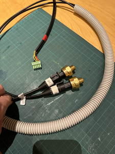

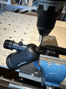

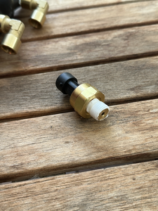

Step 7: Preparing the Pressure Sensor Cables
To protect the cables to the sensors, I ran them through corrugated tubing with a 20mm diameter and screwed on the connector.

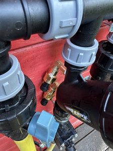

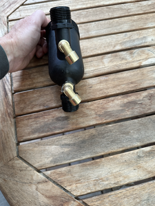

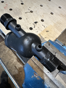

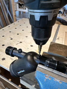

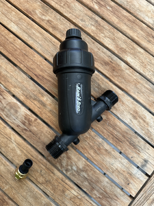

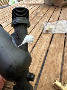

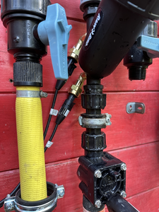

Step 8: Installing the Sensors

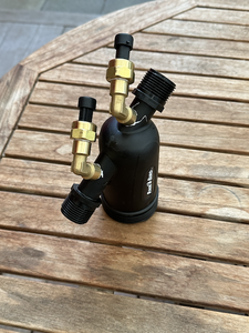

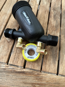

Next up is the filter. For this, you need to unscrew the cap and remove the filter so no drilling debris stays in the filter. I drilled two 6mm holes each and deburred them with a step drill bit.
I gave the housing a good rinse and reassembled it. As you can see, the sensor connections are located on the back of the housing. Also, both the connections on the filter and the pressure sensors have external threads. That’s why you need a coupling with 2 x internal threads. I went with 90-degree angles so the sensors can be mounted sideways.
To make sure the threaded connection between the pressure sensors, angle coupling, and housing is watertight, I sealed the threads with teflon tape. 3-4 wraps should do it. Make sure to wrap the teflon tape from the right direction so it tightens when screwing in. By the way, hemp isn’t an alternative here for copper/plastic connections. Hemp swells up and can damage the plastic.
Now install it back into the water supply system, plug in the connector, and you're done!

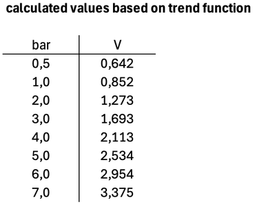

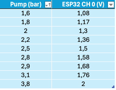

Step 9: Test and Calibration
After switching on the pump, the water pressure rose and so did the display. But what good is a reading in volts?! I needed to convert it to bar.
As a reference, I used the display on my garden pump (Gardena 4000/4 LCD) and set up a measurement series. I opened different irrigation circuits and noted the OLED display reading in volts and the bar reading on the pump.
I entered the results into a spreadsheet and connected the measurement points. Additionally, I added a linear trend line and had it determine the formula. You can’t complain about the linearity of these pressure sensors.
Using the calculated slope of the trend line, I created a calibration table that outputs the appropriate voltage for even pressure values.
These now need to be used in the code. Fortunately, ESPHome has linear interpolation built in. I also adjusted the metadata of the sensor definitions so they display nicely in Home-Assistant.
Since the values are quite jittery, I smoothed them using the median function and used the delta value to ensure changes are only transmitted to Home-Assistant when the value changes by at least 1%.

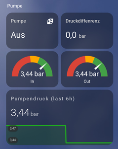

Step 10: Add to Home-Assistant
Now just add the ESPHome device to Home-Assistant and the values are available.
  1. Home Assistant -> Settings -> Devices & Services -> ESPHome -> “Add Device”
  2. Enter IP address, port can stay as is
  3. Enter “API encryption key”
  4. Done!
Now you can add the device to a dashboard. Here’s the Home-Assisant yaml code I’m using in the dashboard:

Step 11: Final Result & Summary
Of course, I had already spent many days thinking about the solution and ordering the necessary parts, but the actual build from breadboard to finished wall-mounted solution really only took one weekend.
The solution has been running for several weeks now and I’m very happy with it. Automations can be triggered and messages sent based on the sensor values. The history is also automatically logged in Home-Assistant. This way you can see exactly when the pump kicked in and how much pressure loss occurs overnight.
I had a lot of fun with this project, and I’ll solve the three problems I mentioned at the beginning next weekend with the appropriate automations and notifications :-)

filters:
- calibrate_linear:
- 0.642 -> 0.5
- 2.534 -> 5.0
- median:
window_size: 7
send_every: 5
send_first_at: 3
- delta: 1%

filters:
- calibrate_linear:
- 0.642 -> 0.5
- 2.534 -> 5.0
- median:
window_size: 7
send_every: 5
send_first_at: 3
- delta: 1%
