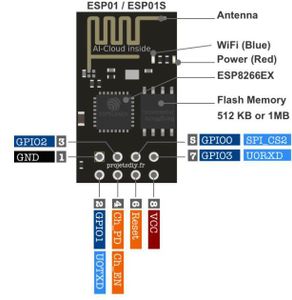

The whole setup is drawn in the schematic. Arduino's usb connection powers the whole thing. Esp-01 and relay board get their 3,3v and 5v power supply from arduino respectively.
+ESP's output enters arduinos analog pin because it outputs 3,3v it must be read as an analog input.
+ESP must be powered on with its CH_PD,RST,GPIO0 pins HIGH. Since this project uses GPIO0 pin as an output, it is connected to arduino's D5 (pwm) pin. This is pretty much why this project needs an arduino. Relay board's 5V input doesn't help things either :) In code while mcu's are prepping, pin D5 pulled high(3,3v hence the pwm pin). Once it is done it leaves the GPIO0 to do its job.
