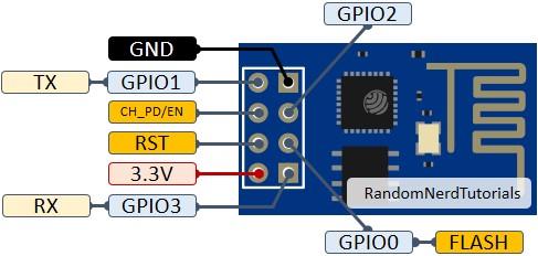

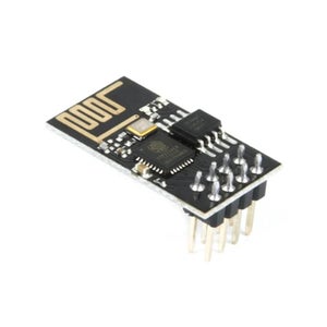

The ESP-01 is a popular, very small and versatile microprocessor module with Wi-Fi. It is based on the ESP8266 chip, designed for adding wireless internet connectivity to your microcontroller projects. While compact and easy to integrate, it only exposes 2 GPIO pins for other peripherals.
I designed an easy to use test circuit that you can use to tryout any circuit based on this microprocessor before making your final design. You will not need a breadboard with many entangled wires, just plug in your ESP-01 and start programming and testing!

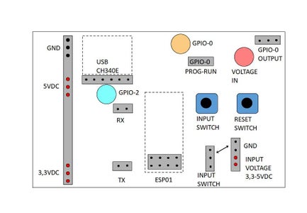

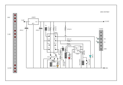

Mount all components on the PCB as shown in the drawings of the circuit diagram and the setup.
Use the 40 pins header female to make the various connection blocks. A few connections at the back must be made with insulated wiring.

First connect a 5VDC power supply on the large connection block on the left.
The first three connectors are GND, connectors 6,7 and 8 are for the 5VDC connection.
If you need 3.3VDC power for some external stuff you can use the last three connectors.

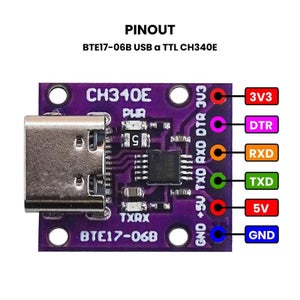

Programming the ESP01 using a USB-C to TTL ch340e Serial module:
Connect the USB-C to TTL ch340e Serial module as shown and connect your computer USB.
Note: This module is only connected to the Rx, Tx and GND connections of the USB of the connected computer, the power supply through this USB connection (coming from the computer) is disregared because it cannot deliver enough current.
