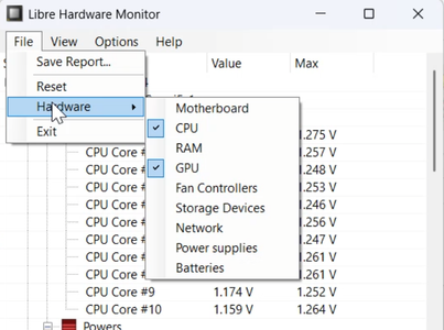

Step 1: Setting Up LibreHardwareMonitor
  1. Download LibreHardwareMonitor from this link https://sourceforge.net/projects/librehardwaremonitor.mirror/
  2. Go to File → Hardware and select CPU,GPU or whatever else you want to display

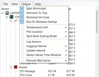

  3. Go to Options and check the following options
  4. Start Minimized
  5. Minimize to System Tray
  6. Minimize on Close
  7. Run on Windows Startup
  8. Go to Options → Remote Web Server and click RUN by default it will run on port 8085. Change it only if you know what you're doing.
  9. Turn off authentication if you are on a private network.

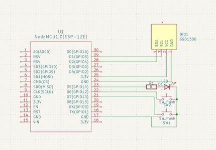

Step 2: Setting Up the ESP
This is a very basic connection (refer schematics)
  1. D1 on ESP to SCL on OLED
  2. D2 on ESP to SDA on OLED
  3. 3V on ESP to VCC on OLED
  4. G on ESP to GND on OLED
  5. D5 on ESP to LED via Resistor and other end to ground
  6. D6 on ESP to Switch(S1) and other end to ground
  7. D7 on ESP to Switch(S2) and other end to ground
  8. Connect VIN and GND on ESP to power supply if needed (make sure the voltage remains between 5V and 12V if supplied to VIN)

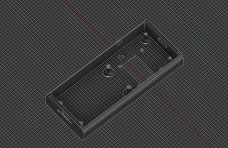

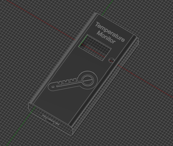

Step 5: 3D Printing
I recently learnt 3D modelling and decided to 3D print for the first time. Here are the files.
The hole on the base is for LED and the hole on the side is to pass wires for the switches.
Further I did not want to power the whole board with microUSB on the Node MCU board so I added a USB C breakout board, the port on the top is for the USB C breakout board and the port on the bottom is for microUSB for debugging or uploading new code.
NOTE-
  1. The screw holes for OLED were not properly aligned, I have added the fusion360 file you can edit according to your display.
  2. If you have your own 3D printer you can print the logo and the text, commercial printers will make a mess so you can remove it.
  3. Upload th .stl files for printing
If you do not wish to 3D print you can just design a basic MDF cover which I was going to do initially.
