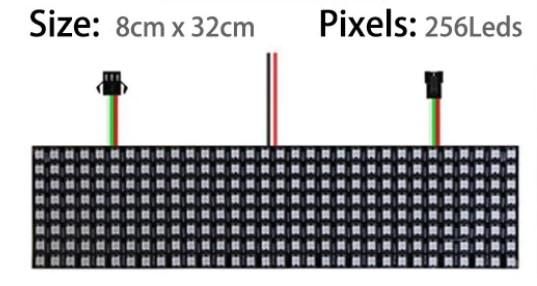

- 8x32 LED matrix WS2812

The WS2812B is a individually addressable RGB LED that allows you to control each LED's color and brightness independently. A color matrix is a grid of these WS2812B LEDs arranged in rows and columns to create a display capable of showing various colors and patterns.

- ESP8266 microcontroller board
- and 8x32 color matrix with WS2812B LEDs
