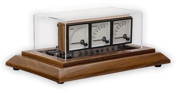

Introduction: ESP32 3D Printed Aviator Clock
An ESP32 Clock Based On Aviation Style 3D Printed Instrument Panel Gauges
I have built another version of this clock using the software from my Power Station Clock details here .
The software works on the Aviator clock with a few changes.
The new version has 1 second updates of the analogue seconds, fast PIR wakeup and hand flyback to home.
Housed on a reclaimed lump of Oak, three off 3D printed instrument gauges show time in hours minutes and seconds.
A secondary display on the seconds gauge also shows seconds on a 7 segment display.
Chimes sound out the hours and quarters and can be set to day, 24/7 or off as required.
The analogue gauges are each driven by a NEMA17 stepper motor while time is automatically fetched from an NTP time server.
A PIR is fitted to shut down the clock when no movement is detected. The clock wakes up and resets the time and display when movement is detected again.
A selector with spoken prompts allows setting of the seconds update frequency, chime times, summer winter setting, chime volume and clock reset.

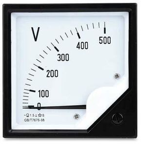

Pic 1 I built a similar clock many years ago using analogue voltmeters with 90° displays.
Pic 4 & 5 The clock worked well but with the tiny 90° displays was very hard to read accurately.
For this clock I wanted 120mm diameter gauges with 95mm wide angle dials very similar to gauges used on aircraft or power stations.
Pic 2 Dungeness B power station style dials.
Pic 3 Aircraft Style Dials
Pic 6 Large 270° panel meters are very expensive and if you want a built in digital display cost around £500.
Pics 7 & 8I designed a gauge for my 3D printer that would work with an aircraft or power station type clock.
The gauges are 120mm across with 95mm dials.

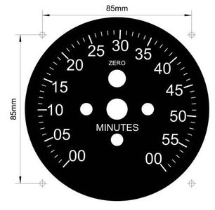

Step 10: Waterslide Decals
Waterslide Decals
Pics 1 to 3 The dials are printed onto whitewaterslide decal paper do not use clear.
I print direct from TurboCAD but test print the enclosed dial images until the 85mm marks line up if your printing from the enclosed images.
Follow the manufacturers instruction as they do vary by brand.
Download the full size images here
Pics 4 & 5 Control Panel Decal Print to match the dimensions between the holes.
Trim printed decal to the black inner line. Paint and prime panel matt black before applying the decal.
Pic 6 To make the decal easier to line up cut/punch out the cutouts before wetting/varnishing.
Pic 7 The "Aviator Clock" label if required is printed on clear inkjet transfer paper if printing on clear 3D material.
