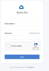

Step 9: Create an Account in Sinric Pro
First, visit https://sinric.pro/
You have to create an account in Snric Pro.
Then log in to Sinric Pro Account.
You will get an APP KEY and APP SECRET for the account, which will be required in the code.

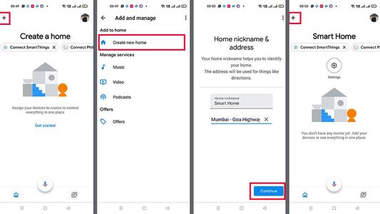

Step 12: Setup the Google Home App
First, download and install the Google Home App. then follow the steps to create Home in Google Home app
  1. Tap on the "+" icon (upper left corner).
  2. Tap on Create new home.
  3. Enter the Home nickname and address.
  4. Then click on Continue.
The Home is created. Now again tap on the "+" icon to add devices.

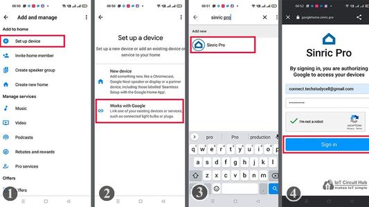

Step 13: Connect Sinric Pro With Google Home App | Add Devices
After creating the Home in the Google Home app, you can connect the Sinric Pro with the Google Home app
  1. Tap on the "+" icon, then select Set up device.
  2. Tap on Works with Google.
  3. Search for Sinric Pro, then select Sinric Pro.
  4. Enter the email id and password used for the Sinric account,
  5. Then tap on Sign in.
Thus, all the devices from Sinric Pro will be added to Google Home Account.

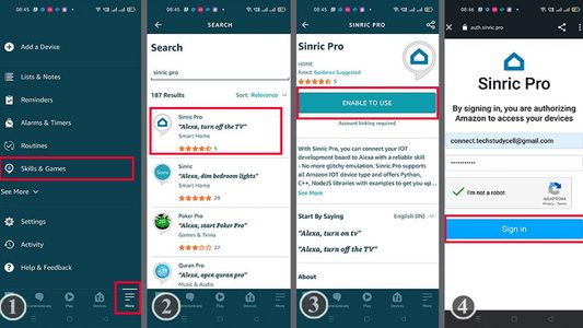

Step 14: Configure the Alexa App for This Smart Home System
Download and install the Amazon Alexa App from the Google play store or App Store.
  1. Go to "More", then select "Skills & Games"
  2. Search for Sinric Pro and tap on "Sinric Pro".
  3. Tap on "ENABLE TO USE"
  4. Log in with the Sinric account credentials.

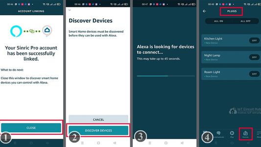

Step 15: Connecting Devices With Alexa
  1. Tap on CLOSE.
  2. Tap on "DISCOVER DEVICES".
  3. It will take a minute to add devices. During this time the ESP32 should be connected with the WiFi.
  4. Tap on "Devices", and tap on "Plug" to see all the devices.
Thus, all the devices from Sinric Pro will be added to Amazon Alexa App.
