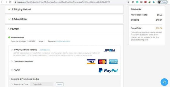

Step 8: Select Shipping Address and Payment Mode
  1. Type the Shipping Address.
  2. Select the Shipping Method suitable for you.
  3. Submit the order and proceed with the payment.
You can also track your order from the JLCPCB. My PCBs took 3 days to manufacture and arrived within a week using the DHL delivery option.

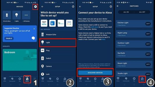

Step 11: Configure the Alexa App for the Smart Home System
Open Amazon Alexa App and follow the steps:
1. Tap on Devices. Then Tap on the "+" icon.
2. Tap on "Light", then select "Others".
3. Goto Alexa and tap on "DISCOVER DEVICES".
It will take a minute to add devices. During this time the ESP32 and Echo dot must be connected with the WiFi.
4. Tap on "Devices", and tap on "Lights" to see all the devices.
