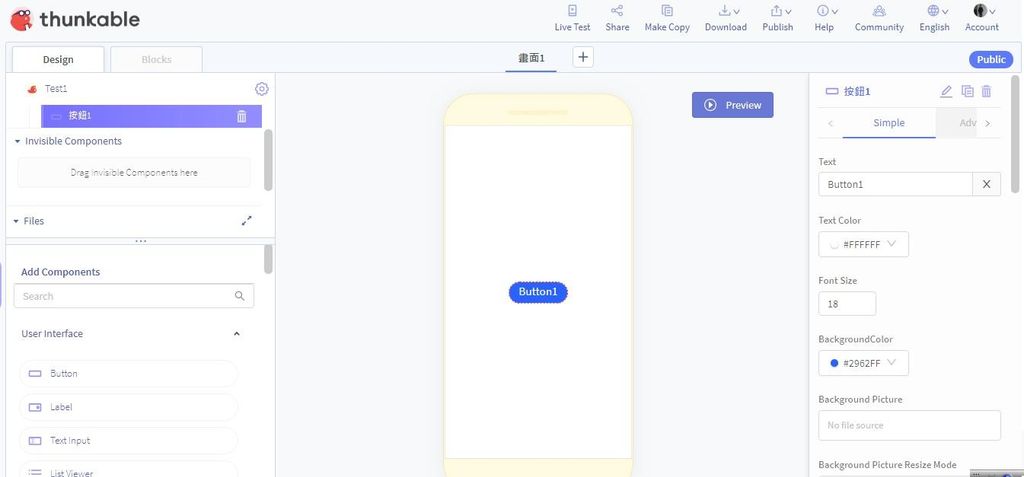

Step 3: App Setup
UPDATE: Thunkable recently transitioned from Thunkable Classic to a completely new platform called ThunkableX which allows users to create apps for both Android and iOS from the same platform but requires a paid membership for making private apps. This tutorial was written using Thunkable Classic and unfortunately isn't accessible to ThunkableX users and there's no way to import from Classic into ThunkableX. However, a contributor has recreated the app in ThunkableX (you can find it here).
Setting up Thunkable
For the Android app we'll be using Thunkable, a fantastic visual app-building tool for Android and iOS. Here we'll just be making an Android app since their iOS support is still in the early stage and doesn't have Bluetooth stuff yet. (Not to mention Apple holds a tight grip on app distribution, etc.)
Go to the Thunkable site and set up an account or log in with a Google account. If you're new to Thunkable you won't see any existing projects, but that's about to change! Click "Apps" at the top left and click "Upload app project (.aia) from my computer". The "native" file type for Thunkable is ".aia" files and these files will allow you to view and edit code blocks within Thunkable. First download the attached file called "ESP32_BLE_Demo.aia" and then load this file in Thunkable. This should now bring you to the app's home screen where you can edit the user interface. To view and edit the code blocks, click "Blocks" sort of at the top left, next to "Designer". This tutorial isn't meant to teach you all the ins and outs of Thunkable, but I definitely recommend you explore it yourself and have fun with it!
Thunkable Companion App
You can also download the Thunkable companion app on your mobile device and do live testing with it, which is really darn cool because you can test the app without having to first compile and download it every time! Simply install it on your mobile device and under the "Test" tab at the top click "Thunkable Live" and it will bring up a QR code on the screen. Open the Thunkable app on your mobile device and scan the QR code to live test!
Now to actually get the app on your phone all you have to do is click "Export" and "App (provide QR code for .apk)" and scan the QR code with your phone using the Thunkable app. You can then install the app and open it! Alternatively, you can download the .apk file I've attached above and email it to yourself to get it on your phone.
When you first open the app it will ask you to turn on Bluetooth if you haven't already, and click "Yes". When the app is connected to your ESP32 it will print out arbitrary values that are sent to it from the ESP32 and the "LED" button allows you to toggle the LED on or off by sending "A" or "B" to the ESP32. But for now let's not jump the gun just yet!
