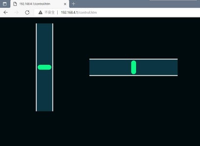

If you're using an iPhone, the built in web interface is the only way to control and setup the robot. After connecting to the robot's AP, open a browser and access the following pages:
- Robot Control : http://192.168.4.1/control.htm
- Robot Setup : http://192.168.4.1/index.htm
For some reason, the control interface doesn't work correctly on Firefox.
