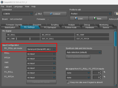

Navigate to the RC Settings tab > Input Configuration > set the RC_ROLL pin mode to: Serial port (Serial API, etc.) This will enable the BaseCam board to receive the serial commands from the ESP32-S3 dev board that's connected to it.

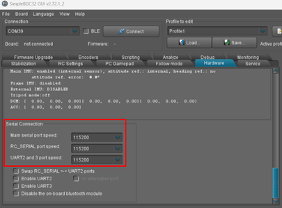

In that same tab (Hardware), scroll down to the Serial Connection section and set both Main serial port speed and RC_SERIAL port speed to 115200. This is the baud rate that is used to communicate with the ESP32 which is connected via its Serial (RX, TX) pins.

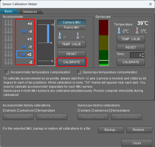

To enable the BaseCam Extended Long controller's on-board IMU to function properly, it needs to be calibrated on at least 2 x axes. To do this, power the BaseCam controller, and lay it flat on/parallel to a tabletop. Press the calibration button and wait until a blue checkmark appears next to the closest axis (e.g. +/-X, +/-Y, +/-Z). Turn the BaseCam board on its other edges, and calibrate the board in each position. The more positions that are calibrated (indicated by a blue check mark), the better.

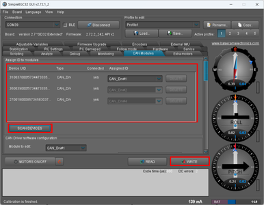

- Navigate to the Firmware Upgrade tab --> Connected Modules sub-tab.
- Select the gimbal motor whose firmware you want to update.
- Select the firmware file using the Browse button, and then click the FLASH button to load the firmware onto that gimbal driver board.
- Repeat the above steps to update the firmware for all 3 x gimbal motors.

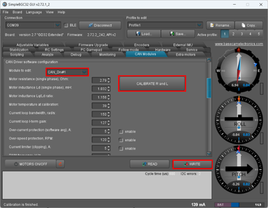

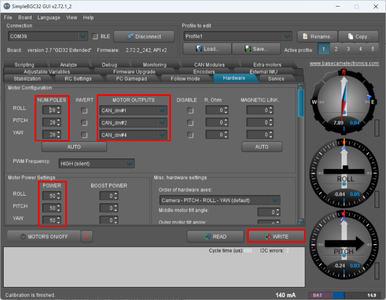

Next, after having updated the gimbal drivers' firmware, in the BaseCam SimpleBGC GUI software, navigate to the Hardware tab. Set the motor poles for each motor to 28 (this is specified in the DM5005 product page on the SMC Powers website.)
Calibrate the resistance (R) and inductance (L) for each motor as well, and click the Write button to save that setting to the motor driver boards after doing so for each motor.

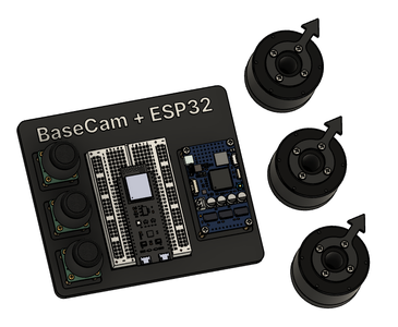

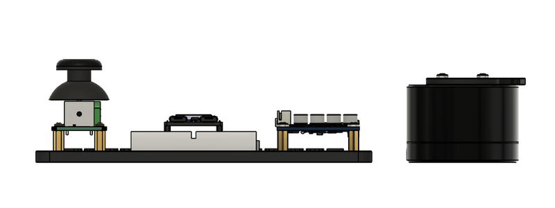

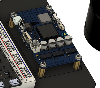

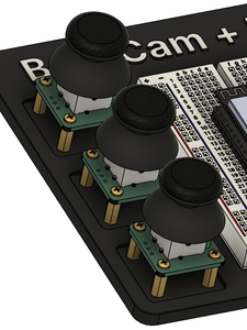

I mounted the single-axis joysticks, secondary/peripheral ESP32-S3 dev board, and BaseCam controller board on a 3D-printed base (files available for download here), and inserted the ESP32-S3 dev board into a breadboard with adhesive backing to stick to the printed base. The joysticks are mounted using M2 x 10mm standoffs. The BaseCam Extended Long board is mounted using M3 x 10mm standoffs. Finally, the 3 x pointer/arrow indicators used to show the gimbal motor directions were attached to the gimbals using M3 x 6mm screws. All 3D-printed parts were printed from 1.75mm thick black PLA+ filament using a Voxelabs Aries 3D printer.

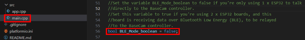

The code is written so the user can choose between the directly-wired arrangement, or a wireless (Bluetooth) arrangement. For this case, set the variable BLE_Mode_boolean in main.cpp to false. Upload the code to the ESP32-S3 dev board with PlatformIO using a micro USB cable, and verify that the installation was successful before proceeding. If you'd like to see any debugging messages from the ESP32, you can leave it connected to one USB port on your computer during operation.

- main.cpp: The primary code that contains the typical setup() and loop() functions for Arduino-compatible scripts.
- The ESP32 initializes its connection to the BaseCam controller first. If the ESP32 has an issue connecting to the BaseCam via its serial pins, it will throw an RX TIMEOUT ERROR message. Double check that your wiring matches the wiring diagram.

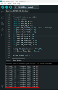

Step 9: Code - Bluetooth Low Energy (BLE) Using 2 X ESP32s
For the Bluetooth Low Energy case, the ESP32 connected to the serial pins on the BaseCam controller board runs the same PlatformIO project code as for the previous case, except In that same code, set the variable BLE_Mode_boolean to true, and then flash the code to the Peripheral/Slave ESP32. The PlatformIO project is saved in zip format on my Github page (https://github.com/TheESTest/BaseCam-ESP32-Controller):
- Basecam_ESP32_Control.zip
The Client/Master ESP32 board, which reads the 3 x joysticks and sends their data out over BLE, runs the following Arduino code, which can be opened and flashed using the Arduino IDE. This code is saved as a zip file at the same Github link above:
- BaseCam_ESP32_BLE_Client.ino
Step 10: Speed Versus Angle Control Modes

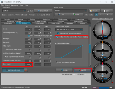

You can select between Angle vs. Speed control modes for the gimbals. For this project, I selected Angle control mode by specifying it in the BaseCam GUI software (on the RC Settings tab.) This also needs to be set in the PlatformIO project's main.cpp file by setting the String object operating_mode to "angle" (or "speed" if you'd like to use the speed control mode instead.) You can additionally play with the "Control in motor coordinates ("servo mode") setting to affect the motor behavior in response to the joystick inputs, and also set a dead-band limit which will instruct the gimbal motors to not move unless a minimum threshold commanded value is received from the joysticks.
