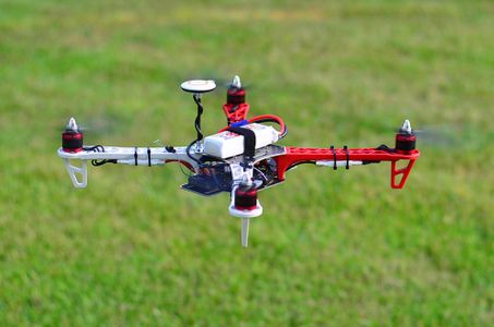

This project aims to design and develop a basic quadcopter flight control system using the ESP32 microcontroller programmed via the Arduino framework. The goal is to create a cost-effective, modular, and beginner-friendly platform to explore the fundamentals of multirotor flight, including sensor integration, motor control, and stability algorithms.The project involves both hardware and software components, where the ESP32 acts as the core flight controller, managing the drone's orientation and movement in real time.
FUNCTIONAL OVERVIEW:
  1. Reads RC commands using a **FlySky PPM receiver** via the `PPMReader` library.
  2. Collects real-time sensor data from an **MPU6050 IMU** over I2C.
  3. Uses a **dual-loop PID controller** (angle + rate) to stabilize roll, pitch, and yaw.
  4. Computes Kalman filter for estimating stable orientation.
  5. Outputs **PWM signals** to four ESCs (Electronic Speed Controllers) using ESP32’s hardware timers.
  6. Monitors **battery voltage** through an ADC pin using a voltage divider and warns the user when voltage drops below safe levels.
  7. Handles tasks in **parallel** using FreeRTOS: flight control and battery monitoring.
