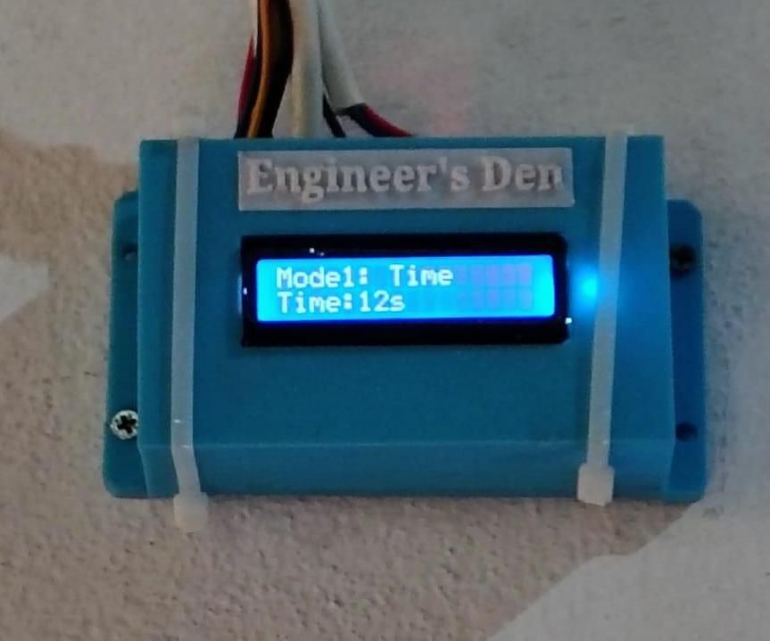

Welcome to the ESP32 Weather Clock with Calendar project! This DIY gadget combines a stylish 20x4 LCD with an ESP32 microcontroller to create a functional clock that also fetches and displays real-time weather updates and calendar events. Perfect for hobbyists and tech enthusiasts, this project demonstrates how to integrate WiFi connectivity, NTP time synchronization, and API calls to create a personalized information hub for your workspace or home.
The clock displays the current time and date, scrolls weather information (including temperature and conditions) from a weather API, and cycles through your day's calendar events fetched via a custom API endpoint. The device is housed in a 3D-printed enclosure, adding a professional touch to its compact design. Whether you're looking to enhance your maker skills or create a practical tool, this project offers a great blend of hardware and software fun!

  9. 3D-Printed Enclosure
