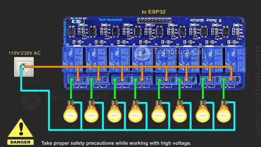

Step 6: Connect the Home Appliances
Connect the 8 home appliances as per the circuit diagram. Please take proper safety precautions while working with high voltage.
Connect 5-volt DC supply with the ESP32. (I have used my old mobile charger)
