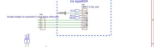

Step 7:
Here we have dedicated support for connecting the MPU6050 easily. The pins XDA, XCL, ADC, etc... are not usually used, so I have left it like that so that I can actually connect other i2c devices like an Oled display.

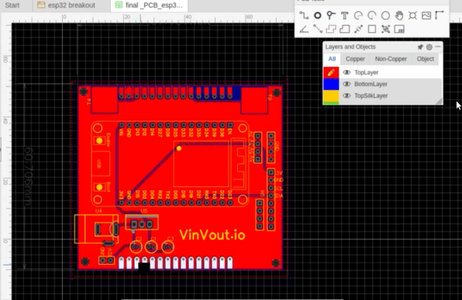

Step 10: Schematics to PCB
Then I converted the schematics to PCB.

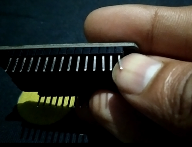

Step 13:
When the boards arrived, it was time for assembly. I soldered the components to the PCB and inserted the Esp32 in its socket.
