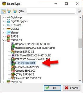

Step 2: Start Visuino, and Select the ESP32-C3 LCD Kit Board Type
Start Visuino as shown in the first picture Click on the "Tools" button on the Arduino component (Picture 1) in Visuino When the dialog appears, select "ESP32-C3 LCD kit" as shown on Picture 2

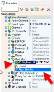

  1. Select "ESP32-C3 LCD kit" board and in the properties window select "Modules" > "RGB LED" > "Brightness" , click on the pin icon and select "Float SinkPin"

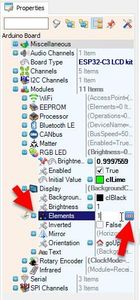

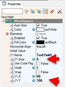

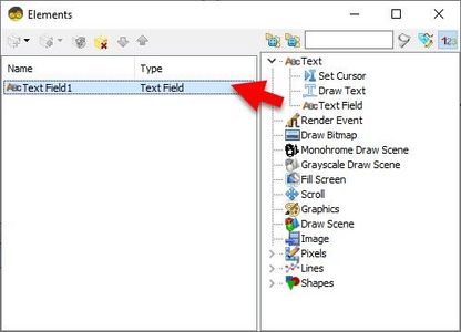

  2. Select "ESP32-C3 LCD kit" board and in the properties window select "Modules" > "Display" > "Elements" , click on the 3 dots button and in the Elements window drag "Text Field" to the left side and in the properties window set "Size" to 5, "X" to 60 and "Y" to 100

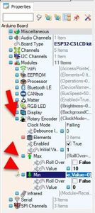

  3. Select "ESP32-C3 LCD kit" board and in the properties window set "Rotary Encoder" > "Max" > "Value" to 10 and "Roll Over" to False, and "Min" > "Value" to 0 and "Roll Over" to False.
