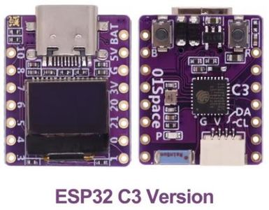

  1. ESP32 C3 OLED

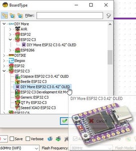

Step 2: Start Visuino, and Select the DIY More ESP32 C3 0.42" OLED Board Type
Start Visuino as shown in the first picture Click on the "Tools" button on the Arduino component (Picture 1) in Visuino When the dialog appears, select "DIY More ESP32 C3 0.42" OLED" as shown on Picture 2
Note: there are a few different ESP32 C3 OLED boards to choose, make sure that you select the one that fits your board

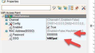

Step 3: WiFi Setup

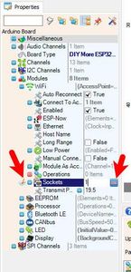

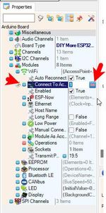

Select DIY More ESP32 C3 0.42" OLED board and in the editor Modules>WiFi>Access Points, click on [...] button, so that "Access points " window will open.In this editor drag the WiFi access point to the left side.
  1. In the properties window Under "SSID" put the name of your WiFi Network
  2. Under "Password" put the access password for your WiFi network
  3. Close the "Access points" window

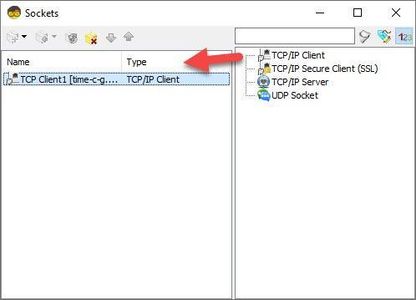

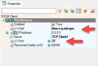

  4. On the left in editor select Modules>Wifi>Sockets, click on [...] button, so that "Sockets" window will open Drag the TCP/IP Client from right to the left side, then Under Properties window set port: 37 and host: time-c-g.nist.gov
  5. Close the "Sockets" window

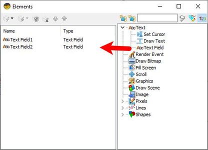

Select DIY More ESP32 C3 0.42" OLED and in the editor Modules>Display>Elements, click on [...] button, so that "Elements" window will open.
  1. In the Elements Dialog drag 2X "Text Field" from the right side to the left

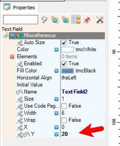

  2. Select "Text Field2" and in the properties window set "Y" to 20
Close the Elements Dialog

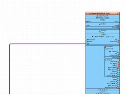

Step 6: In Visuino Connect Components
  1. Connect "PulseGenerator1" pin [Out] to "InternetTime1" pin [In]
  2. Connect "InternetTime1" pin [Socket] to "DIY More ESP32 C3 0.42" OLED" >TCP Client1 pin [In]
  3. Connect "InternetTime1" pin [Out] to "MultiSource1" pin [In]
  4. Connect "MultiSource1" pin [0] "DeleteRightText1" pin [In] and "DeleteRightText2" pin [In]
  5. Connect "DeleteRightText1" pin [Out] to "DeleteLeftText1" pin [In]
  6. Connect "DeleteRightText2" pin [Out] to "DeleteLeftText2" pin [In]
  7. Connect "DeleteLeftText1" pin [Out] to DIY More ESP32 C3 0.42" OLED" >"Display ">Text Field1 pin[In]
  8. Connect "DeleteLeftText2" pin [Out] to DIY More ESP32 C3 0.42" OLED" >"Display ">Text Field2 pin[In]
