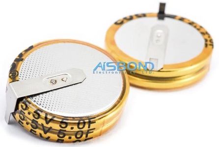

  • 2 x Supercaps of 5F each (or one).

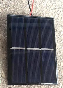

  • 1 small solar panel (8 x 6 cms) of 5V.

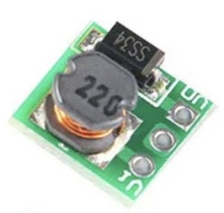

  • Boost step-up converter 0.9V - 5V to 5V

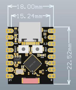

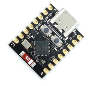

The ESP32-C3 Supermini is a cheap and small devboard that fits very well for this project. It has not a lot of pins available, but we don't need more.
To start testing, you can just power and program it with a USB-C cable; there is no need for a TTL adapter. If you want to run the LED blink program, take into account that the LED is connected to GPIO8.
In the last step, when everything works fine, you will remove the power led and the LDO to save power, because they drain current all the time. Actually, the LDO on the board is not that bad; the quiescent current is about 50uA, but it is still too high. The MCP1700 LDO quiescent current is below 5uA.
To reduce the power consumption in the code, I set the CPU frequency to 10Mhz. Only when it needs to connect to the Wi-Fi I set the CPU frequency to 80Mhz.

On the left side, we have the connector for the solar panel. It will generate power with a voltage ranging from 1V to 5V, depending on the strength of the sunlight. The idea is to use the boost converter to step up the voltage to 5V to be able to charge the supercaps to the maximum no matter how strong is the sun. Actually, with some sun the supercaps are fully charged in a couple of minutes; we don't need to optimize more here.
Then we have the two supercaps in parallel connected to the 5V rail. In the breadboard I use the power rails in one side for the 5V power rail and the other side for the 3.3V rail, with both grounds connected.

The last step to optimize the power consumption is to remove the power LED and the LDO from the devboard. You can do it carefully with a solder iron, flux and solder wick.
If you look at the board image, you can identify the power led and the LDO:
  • Power LED: it's at the top left side, labeled as "PWR". It is tiny, but you can remove instead either the diode or the resistor just above the LED.
  • LDO: it's on the left side, the chip with five legs labeled: SOT23-5. Just remove it. If you had removed the diode in the previous step, probably the LDO is not powered, but when I take the iron solder, I can't stop!
I also put the devboard schematic for reference.
