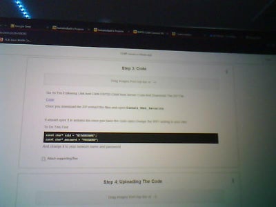

Step 3: Code
Go To The Following Link And Click ESP32-CAM Web Server Code And Download The ZIP File
Once you download the ZIP extract the files and open Camera_Web_Server.ino
It should open it in arduino ide once you have the code open change the WIFI setting to your own
To Do This Find
const char* ssid = "NETWORKNAME";
const char* password = "PASSWORD";
And change it to your network name and password
