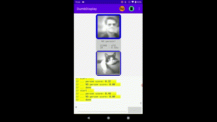

Step 3: Run the Sketch
After uploading the sketch to your ESP32-CAM, you will need to connect it to your DumbDisplay Android app, via Bluetooth with name ESP32CAM. You may want to refer to my previous post -- Setup HC-05 and HC-06, for Wireless 'Number Invaders' -- showing how to make Bluetooth connection with DumbDisplay app.
As hinted previously, the UI is composed of three DumbDisplay layers, laid out vertically.
The top layer is a graphical LCD layer for showing candidate images for "person detection". The candidate images are captured by ESP32-CAM and shown to that top layer continuously. Once you properly positioned the camera, you click on the image -- the top layer -- to trigger "person detection" on the mage.
After "person detection", the image is shown to the bottom layer, which is also a graphical LCD layer. Notice that if person is detected, a green border surrounds the image; otherwise, a gray border is used.
In the middle is a text LCD layer for showing "person detection" status.
  • Whether "person detection" is in progress.
  • After "person detection", the result is presented, showing 1) whether a person is detected, 2) the score of the "person detection" in percentage, and 3) the time it took for the "personal detection" in seconds.
