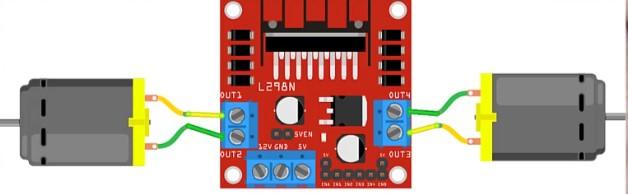

Step 1: Connect Gear Motors to Motor Driver

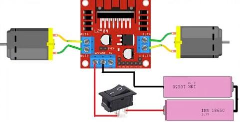

Step 2: Connect Power Switch and Batteries to Motor Driver

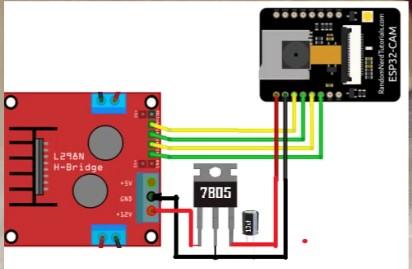

Step 3: Connect Voltage Regulator
Step 4: Connect ESP32 Cam to TTL Converter and Connect to Computer
Step 5: Upload Code to ESP32 Cam
Step 6: Open Serial Monitor and Note IP Address
Step 7: Connect ESP32 to Motor Driver
