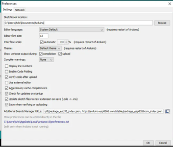

Step 4: Install the ESP32 Add-on
In this case we are using the Arduino IDE to program the ESP32-CAM board. This means that you have to be running Arduino IDE installed as well as the ESP32 add-on. Follow the following instructions on how to set up the ESP32 add-on if you aren't yet:
Installing the ESP32 Board in Arduino IDE
