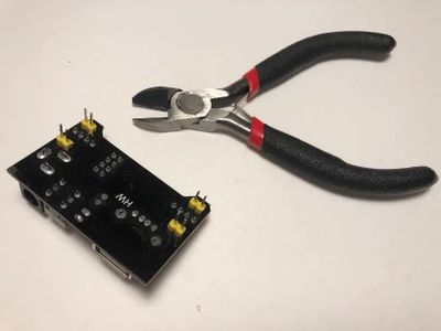

In order to attach the MB102 module to the 18650 Battery Holder, I removed the pins on the bottom of the MB102. Then, I attached it to the cover of the 18650 Battery Holder with double sided mounting tape.
