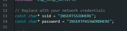

Step 7: Programming the ESP32 CAM
Upload the code to the board but insert your SSID name and password to the relevant sections. Once its loaded, use the serial monitor on 115200 baud to see what IP the device will use. (This may change if not assigned a static IP in your router however you can also check the IP on your router by looking at your connected devices)
Code can be found on GITHUB
