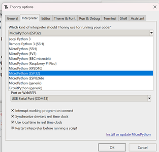

After making the prototype circuit on the bread board we are ready to install the firmware, For that open the Thonny IDE on your laptop. click on 'tools' option and then select 'options...'. Again click on interpreter tab and now first we have to choose the interpreter. Since our camera module is an ESP32 board so we shall select the 'MicroPython(ESP32)'. In the last option we have to choose the comport of our FT232 module. After choosing the right comport.

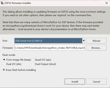

Click on 'Install or update MicroPython' option and then again choose the right com port and the choose the location of the downloaded firmware and then click on 'install'. Now our firmware starts installing.
After completion of the installation process, remove the jumper wire connected between IO0 and GND pins so that our camera module will in normal mode.
