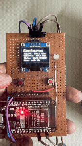

The OLED shows constellation info.
Buttons let you change constellation or toggle auto mode.
LEDs show green if visible, red if below horizon.

Step 6: How to Use the Device
Turn it on at night.
OLED shows:
  1. Constellation name
  2. Azimuth (direction like 274° W)
  3. Elevation (height in sky)
  4. Visible / Below Horizon
  5. Set time countdown
  6. “Steer Me” hints
Press NEXT to change constellation.
Press AUTO to let it cycle every 10 seconds.
Use LEDs:
  1. Green = visible
  2. Red = below horizon
Use web UI on your phone for easy control.
