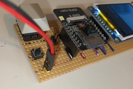

(The small-button on the proto-type is connected to GPIO-0 and puts the ESP32 into Sketch-upload-mode.)

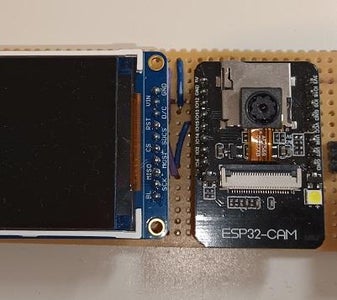

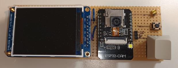

The PCB shown is my proto-type.

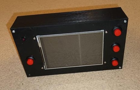

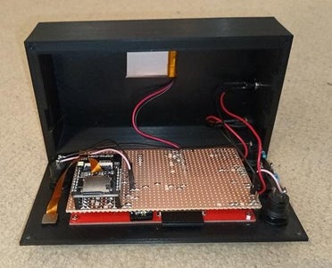

I also have a boxed-unit which is used by my elderly parents. Their grandchildren take photos (of themselves) whenever they visit, so my parents can see/remember who has visited recently.
Step 1: Connections
The Adafruit-TFT is connected to the ESP32-Cam as follows:
  •  Gnd   to 0v
  •  Vin   to 3.3v
  •  D/C   to GPIO-2
  •  RST   not-connected
  •  SD-CS to GPIO-1 via 1k-resistor for safety
  •  LCD-CS to GPIO-15
  •  MOSI  to GPIO-13
  •  MISO  to GPIO-12
  •  SCK   to GPIO-14
  •  Light not-connected
The large-button (normally open) is conneted to GPIO-3 via a 1k-resistor for safety, and to ground. (This is used for taking photos.)
The small-button (normally open) (on the proto-type only) is conneted to GPIO-0, and to ground. (This is used for programming the ESP32.)
Note that GPIO-16 is internally connected to the PSRAM-enable (but might be able to use or something else as well if careful)
Note that GPIO-0 is internally connected to the OV2640-camera (can't use for anything else after boot if you are using the camera)
Note also that this project uses the SD-card on the TFT-display, because this one is connected in SPI mode to the same HSPI bus as the TFT.
(The SD-card included on the ESP32-cam-board is connected in SD-4-bit-mode, which uses some of the HSPI pins, so I don't think can be used at the same time as using a TFT on the HSPI bus.)

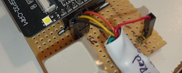

The 3 visible 0.1" pins on the proto-type are for connecting a Serial-to-USB cable for uploading the Sketch.
Step 3: Power Usage
The 2 visible 0.1" pins on the proto-type are for conncting +5V and 0V power supply (current draw when TFT is showing photos is typically 120 to 140mA)

The final boxed-version is shown in the photo. This uses a bigger 4” tft which uses the ST7796S controller chip, and I use the https://github.com/prenticedavid/Adafruit_ST7796S_kbv library.
Note however that the ST7796S boards which I used needed a modification (D1 on TFT_CS needs shorting-out) before they can be used with an SPI-SD-Card on the same SPI bus, as described in https://github.com/Bodmer/TFT_eSPI/discussions/898.
PS. I also use a 1k resistor between the TFT MISO and the SD MISO so if one is trying to pull MISO high at the same time the other is pulling MISO low, then this wont damage any drivers. (Note also that the ESP32 GPIO-12 (MISO) is said to have a weak(~24k) pulldown.)
I also changed some of the pins as follows:
