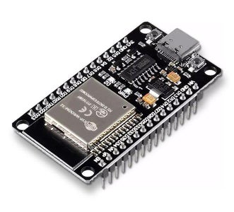

Step 1: The Processor
The circuit uses an ESP32-WROOM-32. Search eBay (or your favourite supplier) for "ESP32 WROOM 32" and choose one like the photo above. I got a 30-pin module; other versions with more pins are available.
(I originally tried to use the ESP32 C3 "Super Mini" but I simply couldn't get it to work - two days of wasted effort. If you search the web you'll find lots of people having the same experience. The "Super Mini" implements USB-Serial in software and I suspect that the Windows drivers wouldn't work on my computer. The ESP32-WROOM-32 has a separate USB-Serial chip and it worked first time for me.)

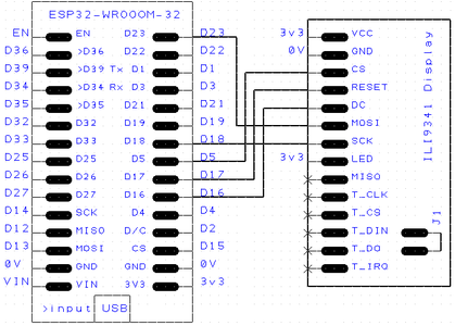

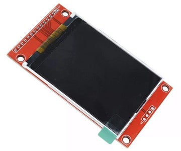

Step 2: The Display

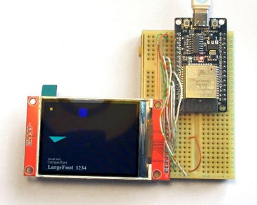

The circuit uses a 2.4" TFT screen with an ILI9341 driver chip and "without touch". Search eBay (or your favourite supplier) for "2.4 TFT ILI9341" and choose one like the photo above. Make sure it has an SPI interface (it will have pins labelled MISO, MOSI, SCK, etc.) and it is 240x320 pixels.
The ILI9341 display driver runs at 3.3V but the TFT display module expects to be powered by 5V. It includes a 5V-to-3.3V regulator. You can power the display by putting 3.3V into the "5V" pin - I've found that to be reliable. But it's better to bypass the regulator. The board should have a jumper labelled J1. Bridge it with a blob of solder.
Test the display with circuit shown above. You can build it on a solderless-breadboard. Copy the following files into a directory called "TestTFT"
- TestTFT.ino
- SimpleILI9341.h
- SimpleILI9341cpp
Compile and upload the sketch; it shows some text, a circle, rectangle, triangle, etc. (In the File|Preferences dialog, set Compiler Warnings to None - my code produces a lot of warnings which I find unhelpful.)

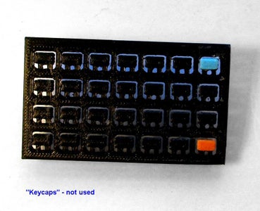

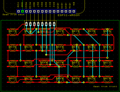

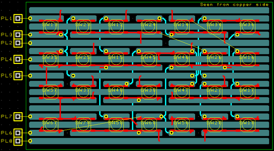

Step 3: The Keyboard

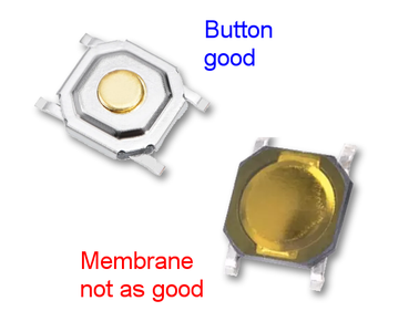

It would be nice to be able to make your own calculator-style keyboards. I couldn't find any good examples on the web. It should be roughly the size of a calculator and look good. I collect old calculators and I particularly like the look of the TI-58 and HP-67 from the 1970s. And I want tactile-feedback.
The "keys" are sold on eBay as "5x5x1.5 Tactile Push Button" and I got 100 for £2 plus postage. They have a little button protruding from the top which I found works well. I also tried the "Tactile membrane switch" from eBay but I didn't like them as much - the "action" wasn't as positive and they couldn't be operated through a cover.

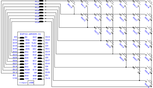

The ESP32-WROOM-32 module has few I/O pins so I use just 8 of them to scan the keyboard. The keys are charlieplexed without diodes which means there are 28 keys:
- 8*(8-1)/2 = 28
(If we used diodes, 8 pins could scan 56 keys but the circuit would be much more complicated.)
The ESP32-WROOM-32 enables pullups on the 8 pins then sets each pin low in turn and checks if any of the other pins have been pulled low. Imagine that each key has a "tag" byte. A bit in the byte is '1' if that pin was set low and another bit in the byte is '1' if that pin was pulled low. For instance "button 53" means that pin 3 was set low and pin 5 was pulled low "button 53" has tag 0x14.
The keys are arranged on the keyboard so as to minimise the total length of their interconnections. There is no "nice" ordering so the result looks random.
I soldered it all together on stripboard using self-fluxing enameled copper wire for the interconnections. The result is not as pretty as a PCB but was quicker to build. (I've included PCB gerbers below if you'd prefer.) The keys are on a 0.4" grid. The PCB is 3"x1.8". In the layout shown above, red tracks are solder blobs (or tinned-copper-wire) on the copper side of the board; cyan and yellow are enameled wire on the back of the board.

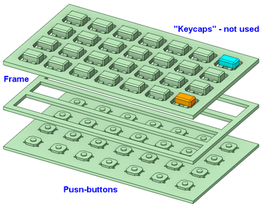

The cover for the keyboard was printed at a local photo printing shop. I find a "photo" is the best quality graphic printing I can produce quickly. A 7x5" print can contain several copies at slightly different scales - you can't be 100% sure how the printing machine will scale it. You can use the photo as it is or cover it with clear self-adhesive film.
I 3D-printed a frame which fits between the keys to make a surface to glue the photo onto. You can use UHU glue or PVA glue ("white glue"). If you don't have a 3D printer, you could cut out thick cardboard or maybe even matchsticks to make the frame.
I tried two ways of printing the keyboard: with and without keys.
For the "with keys" keyboard, I printed a 3D matrix of keys (STL files are below). The matrix is glued onto the frame and the backs of the keys rest on the buttons protruding from the switches. I want the "Solve" and "fn" keys to be different colours so they were printed separately and glued on. It works well and has a nice feel. The captions for the keys are printed as a "photo". The problem is that it's hard to cut holes for the keys. I used a pin to make holes to mark the corners. I then cut the photo from the back with a scalpel. I couldn't get it to look nice. Maybe you'll do better. So I tried a different approach.
For the "without keys" keyboard, I simply glued a "photo" of the keys onto the frame. You can feel the switches under the card as you push them. It works well and is very much easier to make. The "photos" I used are available as PDFs (below).
I think the resulting keyboard looks quite nice.
You could use different pins of the ESP32-WROOM-32 to scan the keyboard but note that D32, D34, D35, D36, D39 are input only and D1, D3 are reserved for serial comms to the USB chip. Some pins have weak internal pullups; it's not clear from the documentation which ones. All I can say is that this circuit seems to work.
You can test the keyboard by downloading and running the TestKbd.ino sketch; when each key is pressed-and-released, it sends the tag value to the PC.

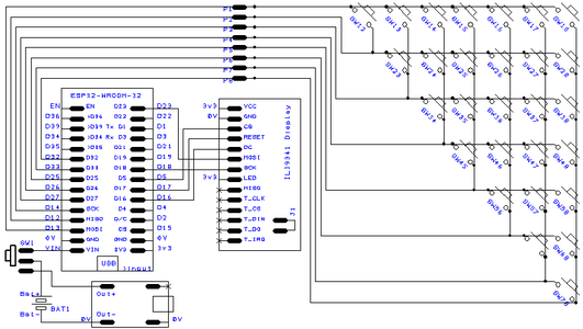

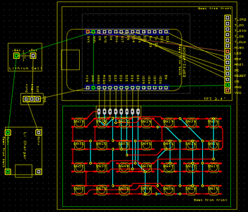

Step 4: The Circuit
The circuit is very simple: an ESP32-WROOM-32, a TFT screen and the keypad. I didn't bother with a PCB (apart from the keypad). I just hooked up the connections with wires - for speed, I prefer self-fluxing enameled copper wire.
It would be nice if you could buy the ESP32-WROOM-32 and the display without pins but I couldn't. So I cut the pins short. Don't try to unsolder them - it's very easy to damage the PCB. I stuck the ESP32-WROOM-32 onto the back of the display with a hot-glue-gun. It gives a convenient solid unit. I positioned the ESP32-WROOM-32 so its USB connector is available in case I need to re-program it.
I used Easy-PC to design the circuit and PCB. The Easy-PC source files are available. It's such a simple circuit I expect you could reproduce it in under an hour using your own favourite design software.

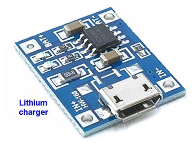

I used a a Lithium cell and a USB Lithium charger module. The charger module cost under £1 and I got a bag of Lithium cells for £0.50 each when a local electronics shop closed. I just soldered onto the terminals of the Lithium cell - yes, I know you're not meant to because the heat might damage it so be quick and careful.
I hot-glued the cell and charger module onto the back of my 3D-printed case and filed a notch for the USB cable. I fitted a transparent "window" so you can see the red/blue LEDs of the charger. Your arrangement might be different depending on what cell and module you use.
The calculator has a slide switch which connects the cell to either the ESP32-WROOM-32 or to the charger. (So you can't use the calculator while it's charging - the charger wouldn't like that.) You can see the connections in the schematic in the previous section.
With the switch "Off", the cell is connected to the charger; when the USB is disconnected, the charger draws around 2uA from the cell (i.e. far less than the self-discharge of the cell).
When the switch is "On", the cell is connected to the VIN pin of the ESP32-WROOM-32. The cell produces between 3.6V and 4.4V. The maximum supply of the ESP32-WROOM-32 is 3.6V and the minimum is 3.0V. The minimum dropout of the regulator at the current we're using seems to be around 0.5V. Those are the values I've measured. So the circuit I use works just fine even though it's "out of spec" according to the data sheets. (If this were a commercial project, I'd probably play safe and use a very low dropout regulator like the XC6203 into the 3V3 pin or a boost regulator into the VIN pin. There is no nice solution.)

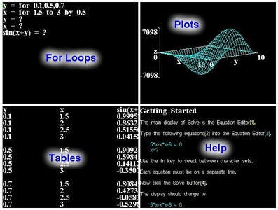

Step 6: The Software
I wrote the first version of this software in BASIC on a Sharp Pocket Computer around 40 years ago. Then I rewrote it in Turbo Pascal, then in Delphi-1, then in Delphi-4 and then in C for this project. So the code isn't as pretty as I'd like but it seems to be reliable.
Upload the code to the ESP32-WROOM-32. Set "Compiler Warnings" to None - my code produces a lot of warnings which I find unhelpful. Even with "Compiler Warnings" set to None, the gcc compiler still produces warnings like "ISO C++ forbids converting a string constant to 'char*'". I wish it would just shut up. I'm not a fan of gcc.
Hold down the '?' key to get a Help page. Help pages can contain numbered links shown in yellow or cyan. Click the number key to display that page or load the example code that follows. There is a page of samples. Download one of them and press the "Solve" button.
The main display of Solve is the Equation Editor. Type the following equations into the Equation Editor.
- 5*x-x*x-6 = 0
- x=?
Use the fn key to select between character sets. Each equation must be on a separate line.
Click the Solve button. The display should change to
- 5*x-x*x-6 = 0
- x=<2>
Solve has found a value for x which satisfies the first equation. The ? in the second equation has been replaced by the answer: <2>.
In the Equation display, holding down a key selects special commands:
- ? Display Help pages
- BS Clear the whole equations screen
- CR Duplicate current line
- SP Delete current line
- Left Load previous saved file
- Right Load next saved file
Some keys can type two characters, for instance 'j' and 'k'. Double-clicking toggles between the two.
If you include a "For Loop" then the solver will produce a table of answers. If you also include variables called "x" and "y" (and no "?") then the solver will draw a graph. If there is also a variable called "z" then the solver will draw a 3D graph.

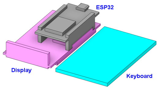

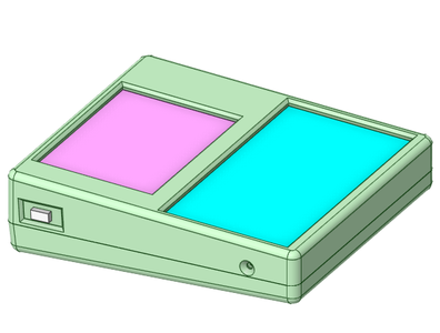

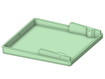

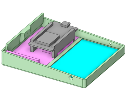

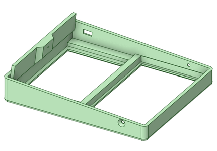

Step 7: The Case
The case is 3D-printed. The STL files can be downloaded (below). The source files for it are available here; they can be edited using the DesignSpark software available free from RS.
If you don't have a 3D-printer, you could make a case out of polystyrene sheet - it would probably give a nicer result.
The boards are held in place with UHU glue and scrap plastic or PLA. You could use a hot-glue-gun or super-glue but I find that UHU is strong enough to do the job and can be un-peeled if you need to change things.
The two halves of the case are held together with three self-tapping screws.

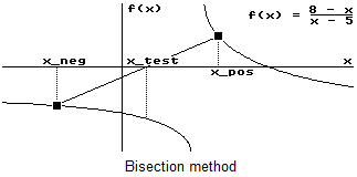

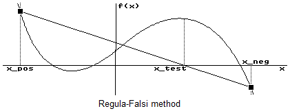

Solve uses the following methods to solve equations containing one unknown:
- Direct method
- Newton-Raphson method
- Regula-Falsi method
- Secant method
- Bisection method

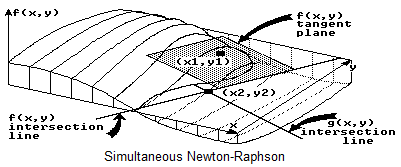

To solve simultaneous equations, it uses:

Direct Method
The Direct method solves equations with only one unknown, for instance
- 5 = sqrt(x+3)
Consider the equation as a tree (see above). The solver knows that the overall value must be zero so it tries to evaluate each side of each binary-node in turn.
If it succeeds with one side then it uses that answer in calculating the other side.
For instance, it knows that the sum node must evaluate to 25 and it finds that the right sub-branch evaluates to 3 so it knows that left sub-branch must evaluate to 22.
Eventually, it will find that one of the sub-branches is the unknown variable.
The Direct method is always tried first with every equation because it is very fast.
The Direct method ignores Initialisations. For instance, in cos(y)=0.5, it will always yield the value of y as +1.047 even though -1.047 is equally valid.

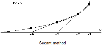

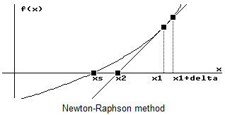

Newton-Raphson Method
The Newton-Raphson method finds solutions to equations of the form
- f(x) = 0
We have some function 'f' of 'x' and want to find a value of 'x' for which f(x) is zero. If your equation has the form:
- sin(x) = 1 - 0.5*x
then treat the '=' as a low priority minus sign and set f(x) equal to:
- (sin(x)) - (1 - 0.5*x)
Imagine we have drawn a graph of f(x) against x and we are trying to find a value of x, call it xs, for which f(xs)=0. We choose an initial value for x, let's call it 'x1', and draw the tangent to the graph at the value of f(x1).
We mark a point where this tangent crosses the x-axis and call it x2. The Newton-Raphson method assumes 'x2' is closer to the point 'xs' than 'x1' was. We can draw another tangent at f(x2) to give us 'x3' and so on (see above).
With luck, the successive estimates of x will get closer and closer to 'xs' and f(x) will get closer to zero. Eventually, f(x) and the changes in x will be so small that that we can be satisfied that we have found a solution.
To draw the tangent we must differentiate f(x): we do so by calculating the value of f(x) at two values of x:
- x = x1
- x = x1+delta
where delta is a small value.
This process is repeated until the change in the estimates of x is less than Accuracy and f(x) is less than Accuracy or no solution can be found.
When an equation has more than one solution, the Newton-Raphson method usually finds a solution close to the initial guess for x.
The Newton-Raphson method cannot solve all equations. In some cases, successive estimates of x get further from the solution; in the case shown above, the estimates cycle through the same values.
It may be that by choosing a new initial guess for x, the Newton-Raphson method will get back on the right track or it may be that you should use an entirely different method.
If there is an arithmetic error while calculating f(x) or if the tangent is parallel to the x-axis then a new initial guess for x is generated.
The Newton-Raphson method is also used to solve simultaneous equations
Regula-Falsi Method
The Regula-Falsi method of solving an equation works with continuous functions.
A continuous function is one where you can draw the graph of f(x) versus x without lifting your pen from the paper. Sin(x) and sqrt(x) are continuous while tan(x) and 1/x are not.
We start with two guesses at the solution, x_pos and x_neg and we choose these so that f(x_pos) is greater than zero and f(x_neg) is less than zero.
If f(x) is a continuous function then a solution f(xs)=0 must exist with xs somewhere between x_pos and x_neg (see above).
We can find a new test point by choosing x_test somewhere between x_pos and x_neg. In the Regula-Falsi method, x_test is where the straight line joining (x_pos,f(x_pos)) to (x_neg,f(x_neg)) crosses f(x) = 0.
If f(x_test) is greater than or equal to zero we set x_pos equal to x_test. If f(x_test) is less than or equal to zero we set x_neg equal to x_test. The difference between x_pos and x_neg must now be smaller than it was.
If we repeat these steps often enough, we will find a solution. We stop the loop when abs(x_pos-x_neg) is less than Accuracy and abs(f(x_test)) is less than Accuracy.
Secant Method
The Secant method is a slight variant on the Newton-Raphson method. We start with two guesses for x: call them x1 and x2. We draw a line through (x1,f(x1)) and (x2,f(x2)) and set x3 to where the line crosses the x-axis.
In the next iteration, we draw a line through (x2,f(x2)) and (x3,f(x3)) to give x4 and so on (see above).
The Secant method has the advantage that it calculates f(x) only once for each step.
Solve uses the Newton-Raphson method to find the first two estimates of x then uses the Secant method. It stops trying the Secant method after a iterations/2 attempts and switches to the Regula-Falsi and Bisection methods.
Bisection Method
The Bisection method is a slight variant of the Regula-Falsi method. In the Bisection method, x_test is half way between x_pos and x_neg.
For some equations, x_test converges on the solution faster with the Bisection method. For other equations, it converges faster with the Regula-Falsi method.
The Regula-Falsi method converges in a single step for linear equations but the Bisection method converges more quickly over a wider range of equations.
Solve uses the two methods alternately when calculating new values for x_test; that way, it gets the best of both.

Simultaneous Newton-Raphson Method
So far we have considered only a single equation involving one unknown. In practice, we often need to solve systems of simultaneous equations. Of the methods used by Solve, only the Newton-Raphson method extends to simultaneous equations.
It is easiest to imagine the simultaneous version of the Newton-Raphson method with just two equations in two unknowns. The unknowns are x and y and the equations we want to solve are f(x,y)=0 and g(x,y)=0.
Imagine the graph of z=f(x,y): it has the form of a curved surface. We choose a test point (x_test, y_test) and find the tangent to the graph at that point. Once again, we can use numeric differentiation.
The tangent is a plane which crosses the x-y-plane along a straight line (see above).
Now we do the same for z=g(x,y). The tangent to the graph at (x_test,y_test) also crosses the x-y-plane along a straight line. Each tangent plane crosses the x-y-plane along a straight line: the "intersection lines" in the drawing above.
Where the two lines cross is where both planes are zero. That's where we choose our new estimate of (x,y).
As in the original version of the Newton-Raphson method, with luck, each new estimate of (x,y) is closer to the solution. We repeat the process until we are satisfied that (x,y) is sufficiently close to the solution.
In N equations with N unknowns, we will end up with N tangent planes. Each Tangent plane is defined by an equation of the form:
- ax + by + cz + d = 0
We solve these N tangent plane equations using Gaussian elimination.
