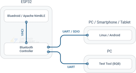

Step 2: ESP32 Bluetooth Protocol Stack
Before we move forward, it’s essential to comprehend the Bluetooth protocol stack, as it sheds light on the reasoning behind incorporating specific functions into our code.
In essence, the Bluetooth protocol stack is divided into two components: a “host stack” and a “controller stack.”
The host serves as the main CPU responsible for executing a Bluetooth stack. ESP-IDF currently supports two host stacks. The default BLUEDROID-based stack accommodates both Bluetooth Classic and BLE. Conversely, the Apache NimBLE-based stack is exclusively designed for BLE.
The controller stack manages the Bluetooth radio, essentially operating as a data pipeline: serial data received is transmitted through the Bluetooth connection, and data incoming from the Bluetooth side is forwarded to the host.
The VHCI interface (software-implemented virtual HCI interface) plays a pivotal role in facilitating communication between the host and the controller.
For more in-depth information, you can consult Espressif’s Bluetooth architecture description.

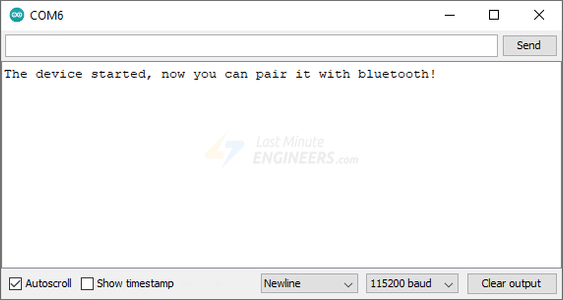

Once you have uploaded the sketch, open the serial monitor at baud rate 115200. You should see a message saying: “The device started, now you can pair it with bluetooth!”.

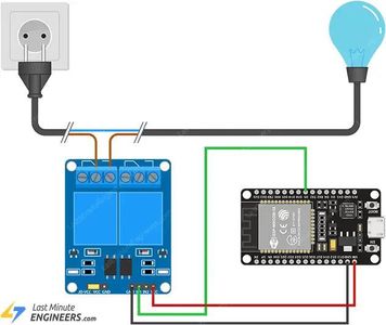

Wiring
Connect the relay module to the ESP32 as depicted in the following diagram. The diagram shows the wiring for a 2-channel relay module; wiring for a different number of channels is similar.
ESP32 Code
Once you are done with the wiring, try the below sketch.
