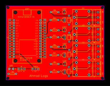

Step 3: PCBWay PCB Prototyping
In order to make my project more compact and professional-looking, I utilized the EasyEDA free online circuit design software to create a custom PCB. The PCB was designed to be 95mm x 70mm in size, and the resulting design is both sleek and functional. I chose to utilize PCBWay's prototyping services to fabricate the PCB due to their excellent reputation as a high-quality PCB manufacturer.
PCBWay is a company that specializes in providing high-quality printed circuit board (PCB) manufacturing and assembly services. With more than a decade of experience in the industry, PCBWay offers a wide range of services including PCB prototyping, PCB assembly, and PCB design. The company prides itself on its advanced production capabilities, state-of-the-art equipment, and highly skilled workforce that allows it to produce top-quality PCBs for various industries such as automotive, medical, consumer electronics, and aerospace. PCBWay is also committed to providing excellent customer service and support, ensuring that each customer's unique needs are met with professionalism and efficiency.
Step 4: Ordering PCB on PCBWay
Ordering a custom PCB from them is a breeze
First go to the PCBWay webiste: https://www.pcbway.com/
On the website input your PCB's dimensions, select your desired quantity and color on their website, and then upload the gerber file. and you're good to go. You can acquire five to ten pieces of two-layer high-quality PCBs for as little as $5, with fast delivery times of 3 to 5 days, depending on your location and shipping preferences.
Download Gerber File
