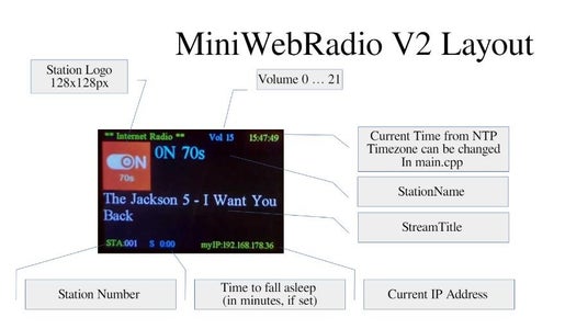

  Immediately after switching on, the big logo appears on the screen, and in the background the device connects to the WiFi network. After a few seconds, the first Internet radio station is activated.
  We can read many informations on the display:
   - Name and logo of the station
   - The currently playing song
   - The volume value
   - Station number
   - and Current IP Adress

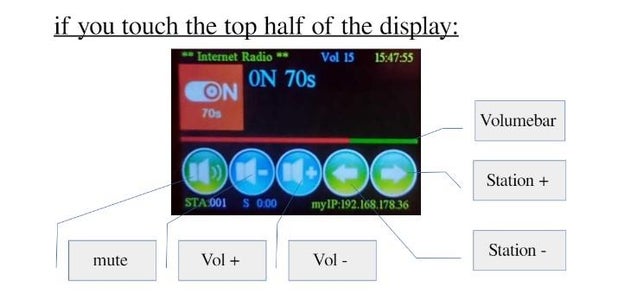

  If you touch the top half of the daisplay:
   - mute
   - volume +
   - volume -
   - volume bar
   - station +  and
   - station -

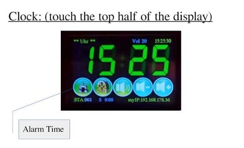

   Clock
   - here we have big digit clock In which the exact time is set automatically via the Internet
   - when we touch the top half of the clock with this button we can set alarm for every day of the week
   - also it have a sleep timer
 In addition, you can view the screen layouts of all functions:

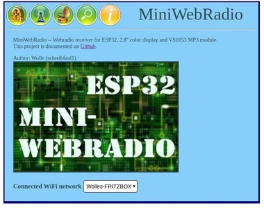

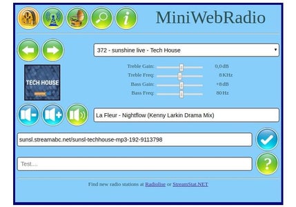

Step 5: Web Interface
 The device in general works surprisingly fast because the images are downloaded directly from the SD card, instead of being drawn using the microcontroller, which is another genius idea of the author. So we can very quickly and easily change the backgrounds, the style of the numbers, insert logos and other characters without changing a single line of code. Also very simple is the method of entering new Internet stations in the "Stations.csv" file, as well as the method of backing up and restoring them. And as if this was not enough, the device can be controlled through a beautiful web interface with many more options as well as "Community Radio Browser" as a search engine. The screen shows the local IP address of the device, which we need to enter in any web browser.
