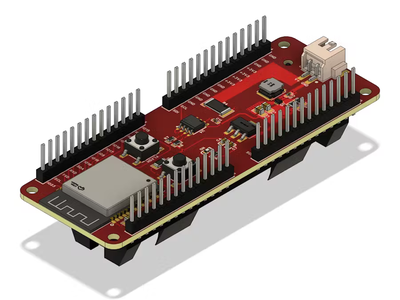

In this article, we will show you how to solve this problem and provide you with the file for an electronic development board based on the ESP32. Through it you will be able to develop countless electronic projects and study energy consumption based on the use of Li-Ion batteries.

See the 2 main electronic blocks to provide 3.3V and +5V power in the electronic board design.
In the first block we have a step-up circuit. It was designed using the TPS61023 CHIP and is intended to operate with an input voltage range between 2.7V and 4.35V. From this input voltage range, the voltage is raised and it provides a value of 5V at the output of the circuit with a maximum current of 1.5A from a single-cell Li-ion battery. See the complete TPS61023 datasheet and check the application note.
From this voltage, we use an AMS1117 voltage regulator to regulate the voltage and provide a value of 3.3V to power the ESP32 circuit.
The electronic board has several +5V, 3.3V and GND pins. The purpose of these terminals is to facilitate the power connection of other modules and electronic components to have more flexibility when creating electronic prototypes. See the figure above.
