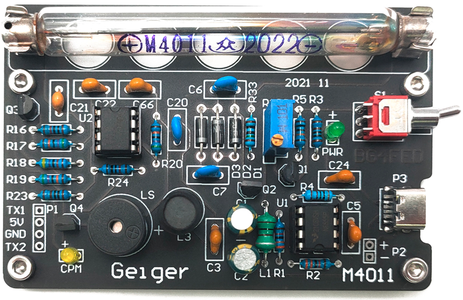

- A geiger counter with a TX output pin - I used this: https://www.aliexpress.com/item/1005004019027282.html

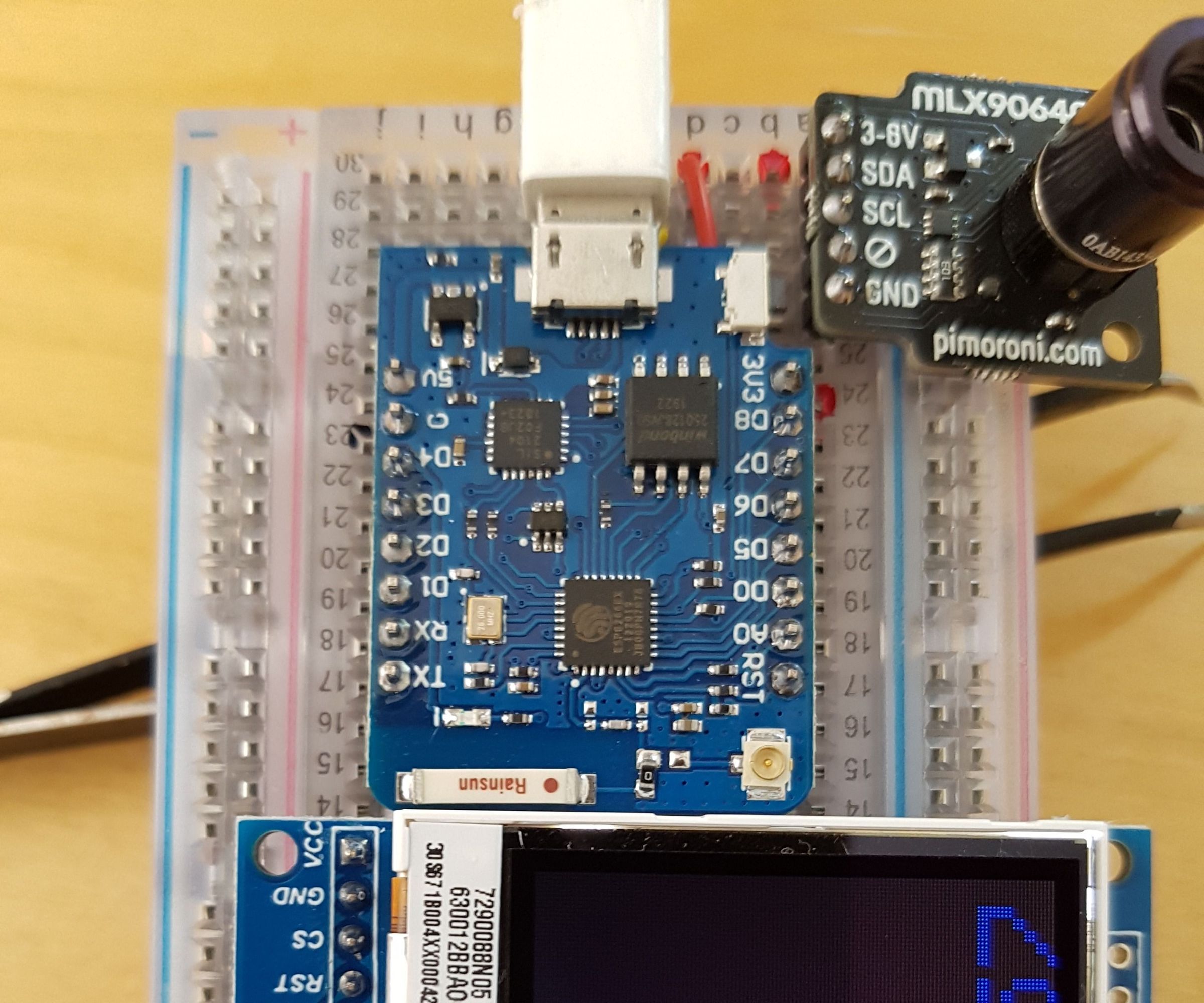

Step 3: Wiring the ESP32 Up to the Geiger Counter
Wiring:
- Solder "5V" from the Geiger to "VCC" on the ESP32
- Solder GND from the Geiger to GND on the ESP32
- Solder "TX1" from the Geiger to GPIO16 (probably labelled IO16 or similar - check your ESP32 Board pin diagram to be sure)
Power on and test!!
The ESP32 LED (blue usually) should blink approximately once per second, which indicates it is alive. After about 1 minute, check your iotplotter.com web page to see your data being collected.
