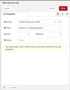

Step 3: Create a Dashboard Using Node Red
For Air Quality Index Dashboard
  1. Open node red
  2. Add MQTT In Node
  3. Add Debug Node
  4. Add Gauge Node
  5. Connect Debug and Gauge Node to MQTT In Node
For Led
  1. Add Switch Node
  2. Add Function Node
  3. Add MQTT In Node
  4. Connect Function Node to Switch Node
  5. Then, Connect MQTT In Node to Function Node
Follow the diagram attached above.
Step 4: Download MY MQTT on Your Phone
  1. Download My MQTT on your phone
  2. Subscribe to the topic
  3. The Dashboard will be shown in the image attached above.

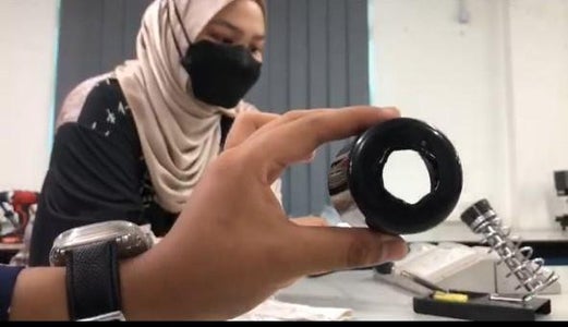

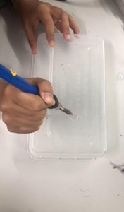

Step 5: Prepare the Container
  1. Get a container that can fit all the components needed.

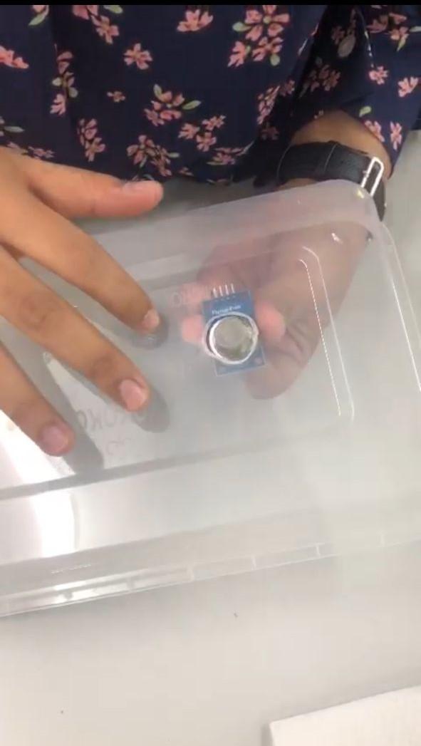

  2. Make a hole under the container that can fit the head of the gas sensor.

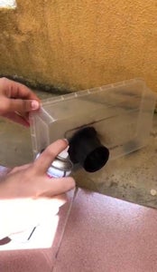

  3. Spray the waterproof leaking spray if there is any leakage after making the hole.
  4. Take a small cup to cover the head of the gas sensor from the rain or sun.

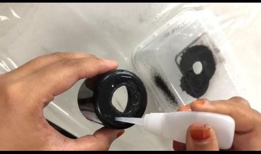

  5. Make a hole at the bottom of the cup, make sure the hole is the same size as the hole from the container.

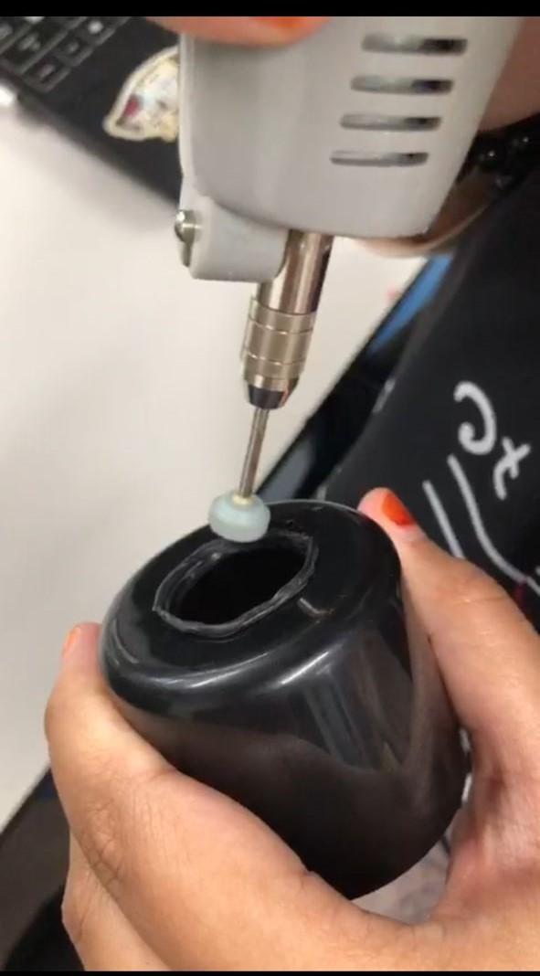

  6. Grinding the surface of the cup to make it a bit rough for the glue to stick harder.

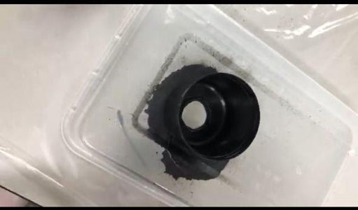

  7. Attach the cup with the container using any glue.
  8. Sealed once again with the waterproof leaking spray to make sure no water can get inside.

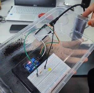

  2. Attach the MQ135 sensor at the hole made earlier.
  3. Put all the components inside the container.
  4. Organize all the components neatly to fit the container.
  5. Use tape or glue to stick all the components inside the container.
