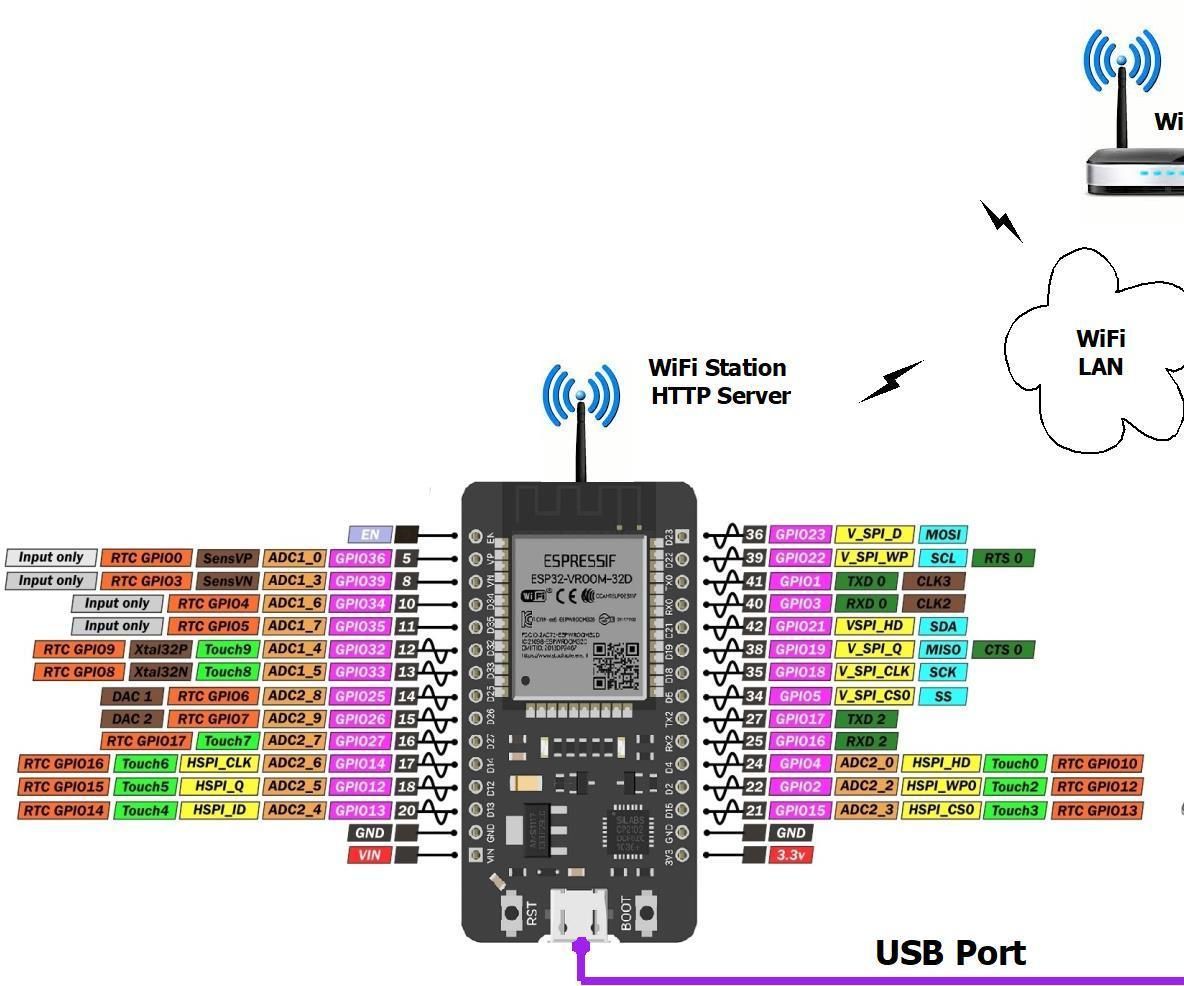

Step 4: Schematic
SD Card module provides “micro-SD card socket”, for inserting the memory card and then provides SPI interface pins (MOSI = GPIO12, MISO = GPIO13, SCLK = GPIO14 and CS = GPIO27), for connecting it into ESP32 board.
SD Card module converts the +5VDC supply into 3.3VDC using AM1117, 3.3VDC regulator and converts the 5VDC logic Pins into 3.3VDC logic pins by using “74ABT125PW, Quad Buffer Tri state logic converter”.
The micro-SD card should be powered and operated with 3.3VDC. Otherwise, connecting the 5VDC logic into microSD card, can permanently damage the memory card.

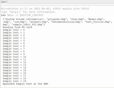

During startup, the SPI bus and SD card is initialized.
Initially a “sample.txt” file is created / opened with FILE_WRITE option.
If file open is success, then the program writes running numbers (0 to19), into “sample.txt”, and then closes.
The program once again opens the “sample.txt” with FILE_APPEND option, and appends a text at the end.
Then the program once again opens the “sample.txt” with FILE_READ option, reads the “sample.txt” and send data to the debug port, which prints text on connected debug terminal.

The experiment is successfully executed with ESP32, SD Card Module, and 8GB micro-SD card
A “sample.txt” file is created, written with running numbers and then readback / printed the text via debug port.
