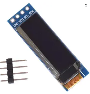

0.91" 128x32 IIC I2C Display

SD1306
[+] pin -> ESP32 [3V]
[-] pin -> ESP32 [GND]
[SDA] pin -> ESP32 [Pin 21]
[SCL] pin -> ESP32 [Pin 22]
