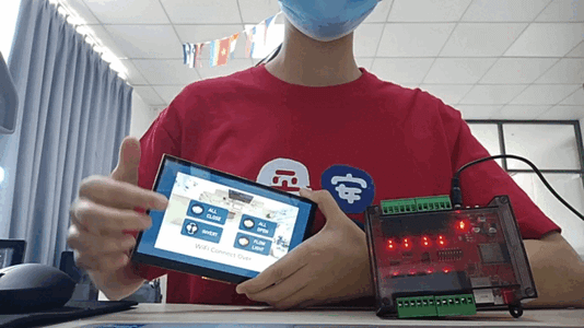

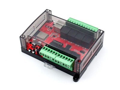

Ok, look, configuration relay with home assistant, when the the 7" display request the webhook, it can control the relay all close, all open, invert, flow light.

  4. Configuration relay.
  5. Set up Automation as shown in the figure, and select When a Webhook payload has been received as the trigger condition.

Step 4: Result
In the video, when I press the button, the relay will react accordingly. Of course, it not only just simply control relay, the HA is powerful, by configuring Devices, setting up Automation, and finally requesting webhook using 7" screen, you can control the devices you want with a 7" screen.
