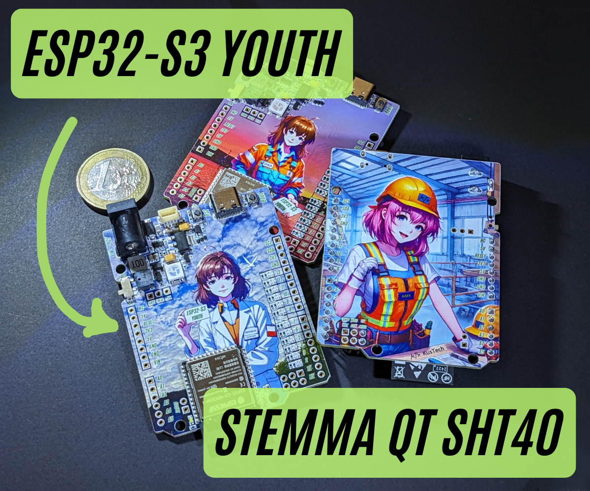

What is this board?
The ESP32-S3 Youth is a microcontroller board based on the ESP32-S3 chip from Espressif. It includes WiFi, Bluetooth, and plenty of useful features that hobbyists and microcontroller fans will appreciate.
The board’s design is inspired by the Arduino Uno form factor, with a few ideas borrowed from the Adafruit Metro series, plus my own additions—features I’ve always wanted when programming these boards.
What makes it special?
- A unique and eye-catching Anime design.
- Arduino Uno form factor for compatibility with many shields.
- LED indicators for pins 2–13 (because who doesn’t like blinking lights?).
- A physical power switch to turn the board on or off.
- Supports input voltage up to 28V.
- LEDs and NeoPixel for colorful fun.
- A buzzer for sound effects.
- A Stemma QT connector for add-ons.
- Reset and Boot buttons for easy programming.
- Works with Arduino IDE or CircuitPython.
And the best part? It’s the first colorful anime-themed board with ESP32! Some people say redheads don’t have souls, but I definitely put mine into this project.
