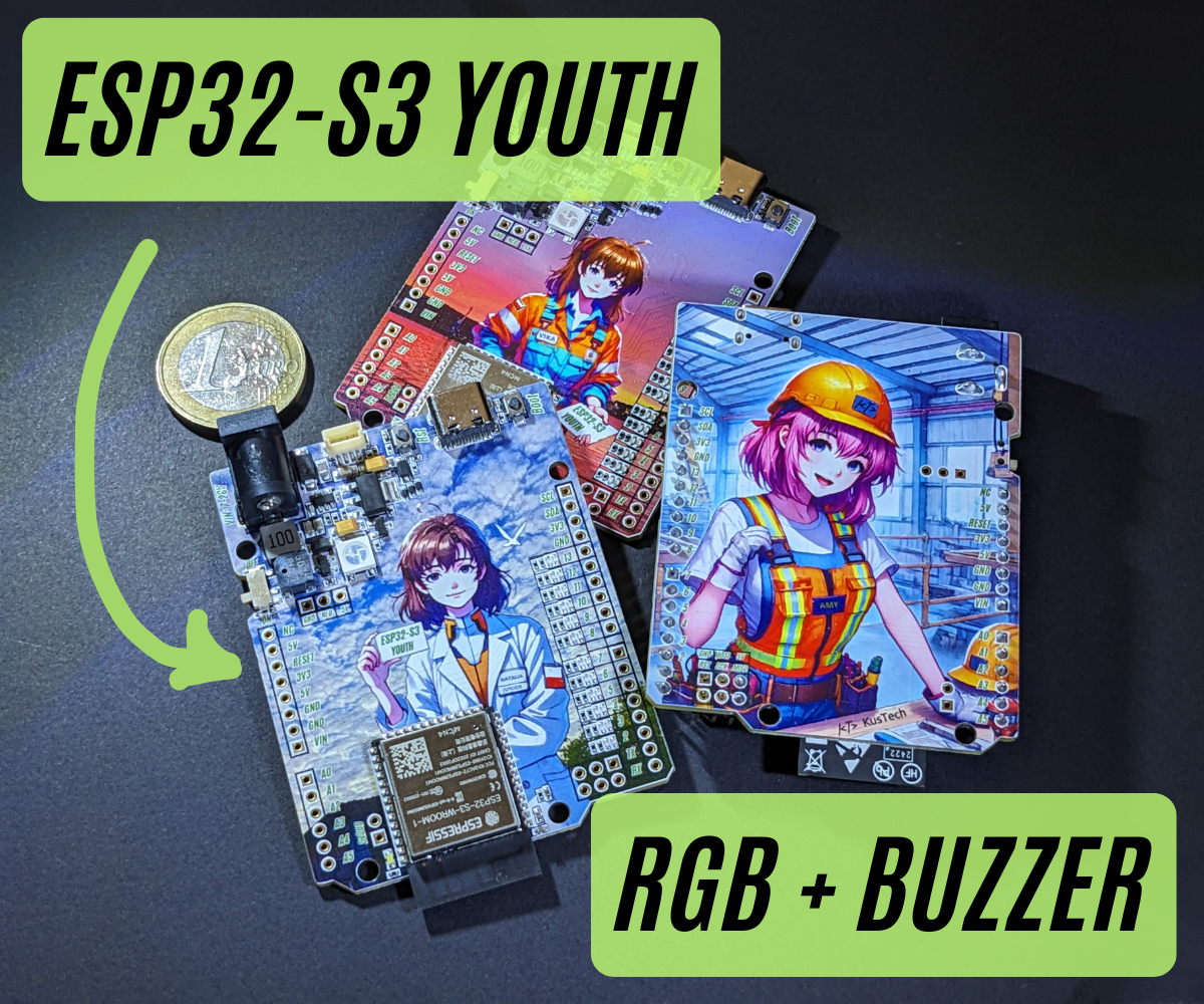

In this article, I’ll show you how to connect a sensor with a STEMMA QT connector from Adafruit. We’ll use the popular and reliable SHT40 temperature and humidity sensor as an example.
Before we start, make sure you’ve read the article where I explain what this board is, how to configure the Arduino IDE, and how to upload your first code. It’ll make things a lot easier.
