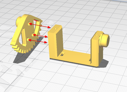

I tried to make body as light as possible, as small servos not very powerful. That is why you will need to glue some parts together. Promise it is not so hard =)
Make sure that gluing surfaces are flat, use some flat mini file and make sure parts can be connected to each other without space between. Then glue it together as shown on images.
Servo gears
Cut servo horn (see image) to fit it inside servo gear part and glue it together.
