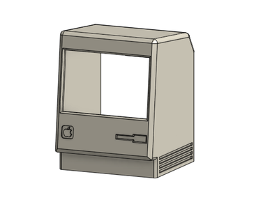

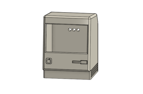

Step 1: Designing
The Macintosh enclosure was designed in Onshape. I was inspired by photos of old computers, especially vintage Macs. The original author of the photo is Science & Society Picture Library / Getty Images.

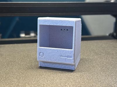

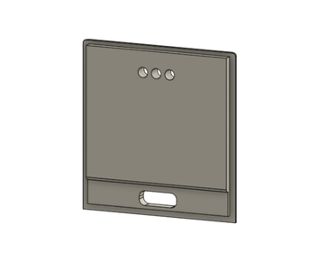

Step 2: 3D Printing
The two needed parts can be 3D printed in PLA. The first one is the main part of the case, which should be printed with the front face facing downwards. Supports have to be turned on, but additional support blockers must be added everywhere except under the main screen plate section.
