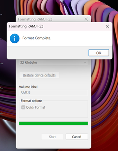

Step 2: Formatting the Micro SD Card
Before inserting the micro SD card in the SD card slot of the the ESP32 camera, format your micro SD card and create a new new folder and rename it as 'sd'. Again create an another new folder inside the sd folder and rename this as 'images'. Now eject the micro sd card form the laptop and insert it inside the micro SD card slot of the ESP32 camera module.
